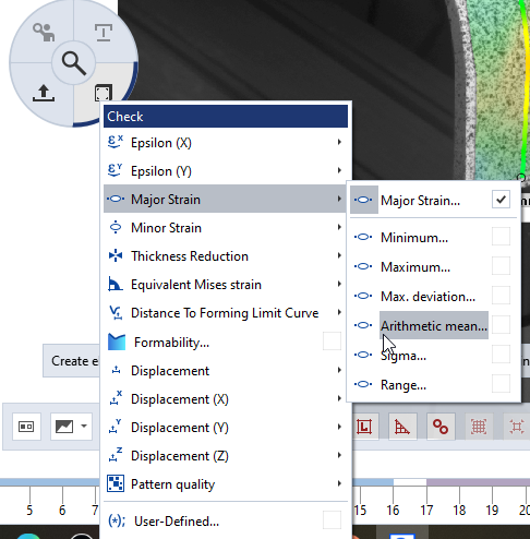

[Au...] Posted June 18, 2021 Share Posted June 18, 2021 Is there way to calculate average strain over a predefined geometry such as a rectangle? I can create a surface component with a hand drawn polygon, but was looking for something more precise like one that is based on a rectangle. Link to comment Share on other sites More sharing options...
[Iv...] Posted June 22, 2021 Share Posted June 22, 2021 Hi Austin, you can create a "component region". (Operations→ Component → Component Region) where you can select a region upon your surface component. With the selection tool "Select inside Cube" (Edit → Selection in 3D → other selections → Select inside Cube) you can create a defined cube. Every connection between nodal points within the Cube will be selected and a region will be created. This region is not 100% rectangle but nearly. I hope this helps. Greetings, Ivan Link to comment Share on other sites More sharing options...

[Na...] Posted April 26, 2023 Share Posted April 26, 2023 Hi Ivan, I could make a rectangular frame out of the surface component with your explanations. Now, can you please guide me how can I calculate the average strain over this rectangular area? Link to comment Share on other sites More sharing options...
[Iv...] Posted May 3, 2023 Share Posted May 3, 2023 Dear Nasser, open the I-Inspect or go the long way via the inspection menu and search for the inspection you like to calculate. Then you find the average in this area. Link to comment Share on other sites More sharing options...
