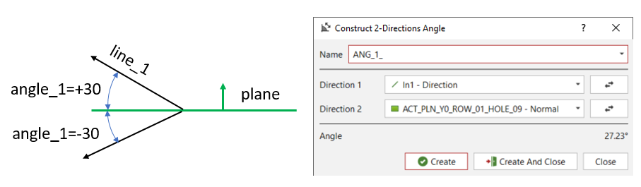

[Ad...] Posted March 29, 2023 Share Posted March 29, 2023 Dear All I would like to measure angle between plane and line, but depending on line orientation i would like to have positive or negative value. Is it possible ? With method illustrated below i always get positive values. Instead plane i could use other type of geometry if this would help, for example axis system or another measurement method. Best Regards A.B. Link to comment https://qualityforum.zeiss.com/topic/2805-how-to-meaure-negative-angle/ Share on other sites More sharing options...
[Be...] Posted March 30, 2023 Share Posted March 30, 2023 Hi, sorry, in general, angles are not negative. But what you can do instead: Check rotations of coordinate systems. Unfortunately the construction is a little bit more complex even if you only need one axis! Construction two coordinate systems: First coordinate system: First direction (X) is the "projected" line in the plane and second direction is the normal of the plane (Y) Second coordinate system: First direction is the line (X) and second direction is the normal of the plane (Y) Create a 2-coordinate-system distance Check this coordinate system on a rotation in Z Hope this helps?! Regards, Bernd Link to comment https://qualityforum.zeiss.com/topic/2805-how-to-meaure-negative-angle/#findComment-7391 Share on other sites More sharing options...
