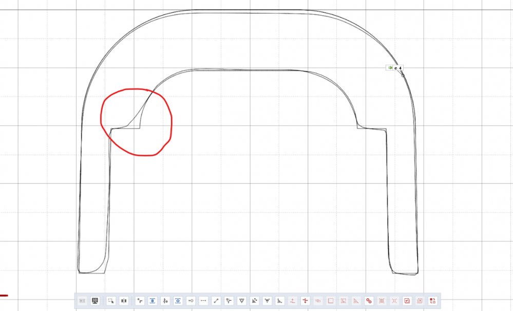

[Th...] Posted April 5, 2023 Share Posted April 5, 2023 i regularly measure plastic items, and often come across designs with 90 degree right angles but deformed into radius, i don't know how to catch the exact point Link to comment Share on other sites More sharing options...
[Ja...] Posted April 5, 2023 Share Posted April 5, 2023 Well as you say , there is no point here to assess! Locations of these types of features are notoriously ambiguous. You could think of it as a line/ surface profile in that area if the design is concerned by form. Link to comment Share on other sites More sharing options...
[Da...] Posted April 6, 2023 Share Posted April 6, 2023 we are doing this things manualy all time Link to comment Share on other sites More sharing options...
[Di...] Posted April 11, 2023 Share Posted April 11, 2023 Hello You can catch a Theoretical Edge point created by the intersection of two lines or from the intersection of a line with a circle on a curved surface and then project this point to your scan but from what I see here is that you do not have a good definition of the form that you are scanning The 90° angle/straight corner is hard to obtain not to say impossible to acquirer but you can get an approximated value to the real situation but you need to be more precise on you digitalization to have a good value Link to comment Share on other sites More sharing options...
