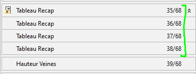

[Ju...] Posted February 5, 2024 Share Posted February 5, 2024 Hi Nanno, this is very usefull but... If a page had multiple pages like : the count is not working... is there any solution to get the "real" page number ? Thank a lot Link to comment https://qualityforum.zeiss.com/topic/2867-show-report-page-numbers/#findComment-10334 Share on other sites More sharing options...
[Ri...] Posted February 13, 2024 Share Posted February 13, 2024 Just change the for loop to: for i in pages: for j in i.pages: page_nr = page_nr + 1 try: print('Page ', page_nr, 'has tag ', j.tags[0]) except: print('No tag: page ', page_nr) #no_tag.append (j) Link to comment https://qualityforum.zeiss.com/topic/2867-show-report-page-numbers/#findComment-10418 Share on other sites More sharing options...
[At...] Posted February 13, 2024 Share Posted February 13, 2024 I'm stupid it was so simple ! Thanks a lot for your help Riccardo ! Link to comment https://qualityforum.zeiss.com/topic/2867-show-report-page-numbers/#findComment-10430 Share on other sites More sharing options...
