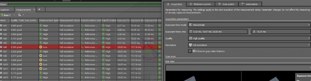

[An...] Posted April 28, 2023 Share Posted April 28, 2023 I want to edit my exposure times because its totaly worng - its everything too light. Meybe after calibration something has changed ... i dlike to set my exposure times the same to all my measurements 1-19 How can i do it ? Now i'm doing it like that: (M1) go to position, F4 manualy edit my exposure time, and (M1) update the position and so on up to M19 Is there faster way ? Link to comment Share on other sites More sharing options...
[Na...] Posted May 2, 2023 Share Posted May 2, 2023 Hello Andrzej, you can actually select all measurements at the same time and press F4. The settings will be applied to them at the same time. Sometimes the same manual exposure times are not the best solution and you might want to change to an automatic exposure time. Regards, Nanno Link to comment Share on other sites More sharing options...
[An...] Posted May 4, 2023 Author Share Posted May 4, 2023 ha so this is the way 🙂 thank you Link to comment Share on other sites More sharing options...
