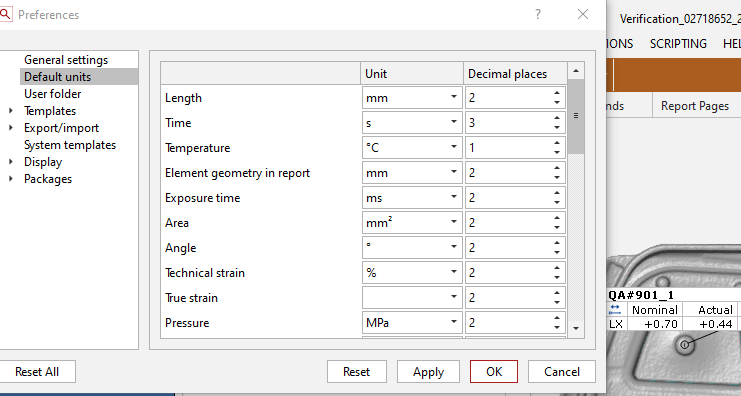

114622572_PlaceH.PNG.ddade66b97d6f088995b309fce53d7f4.PNGHello team,
I need to make bellow change in few old programs :
How can I change the ratio from 0.00 to 0.000 without editing  "PLACE HOLDERS " in the entire report. ? Currently "range" must be redone after this change to 3 decimal places. Is there a shortcut?
Hi!
You can use "reconfigure reports" from the context menu of the reports to change the setting in the reports after changing it in the preferences.
Kind regards,
Thomas Trentmann

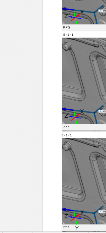

HI !
This how i work now. I need advice about question 2 .
"Currently "range" must be redone after this change to 3 decimal places."
-Can I avoid resetting of the RANGE, after I change decimal places ?Range.thumb.PNG.ec7ed04bc4f2f9708100acca35151442.PNG
