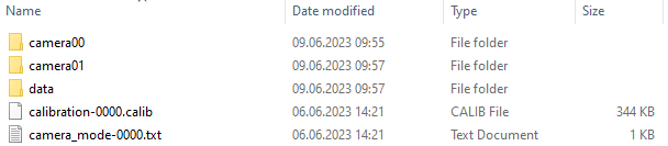

During a Deformation Tracking measurement, I recorded images using the frequency divider function. The resulting images were saved in a separate folder. I forgot to enable the automatic import of the stages into the project. How can I manually import the stages into the project?

to import an external image series in the SW21 or SW22 you need an additional fee required import license.
