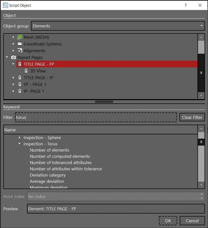

[Ti...] Posted November 5, 2023 Author Share Posted November 5, 2023 I know you all said this isn't up for consideration soon. But what is this: Link to comment Share on other sites More sharing options...
[Ch...] Posted November 6, 2023 Share Posted November 6, 2023 This are the remains from our first try to implement a torus element that was taken a decade ago. Of course it would be better if these token would be invisible but it is not a critical bug at all, so do not expect that we fix it very soon. During this first try we have found out that we doesn't understood the problem and the needed use cases deeply enough. That is one of the reason that we always asking for real projects and inspection task to find out what is really needed. Sorry, but this token doesn't mean that we have started to work on the torus topic since your last post. Best regards Christoph Schult Link to comment Share on other sites More sharing options...
