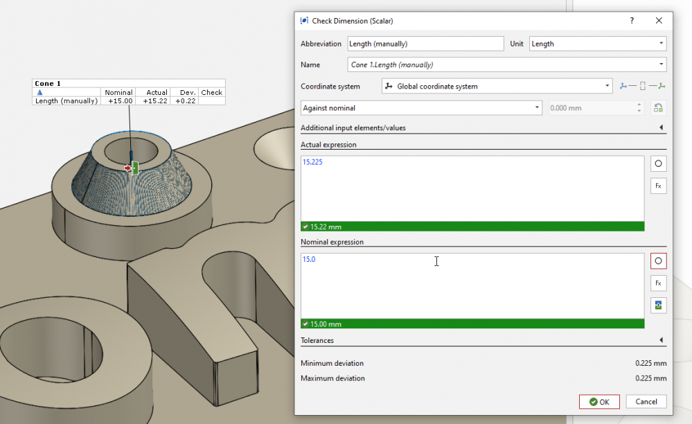

Hello to all,
II would like to know if it is possible to enter a dimension measured manually, eg a thickness measured by caliper, in the program and how to execute it so that it comes out in the report.
Thanks
Nuno
Hello Nuno,
one solution is to use a user defined check on the element (e.g. a nominal distance) in I-Inspect. There you can enter values for nominal and actual by hand. Make sure to chose the right unit of the check on the top right of the dialog, so the software handles the check like a length for example.
