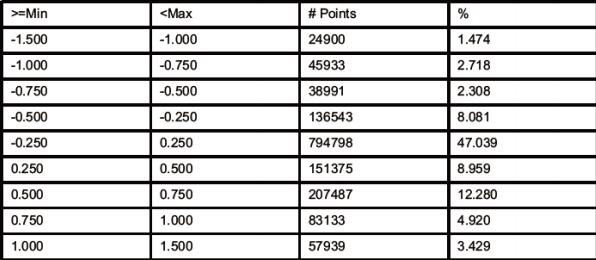

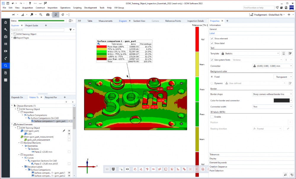

[Na...] Posted July 27, 2023 Share Posted July 27, 2023 Hello, the surface comparison has a label template "Statistic", which will show these values depending on the tolerance legend. Link to comment Share on other sites More sharing options...

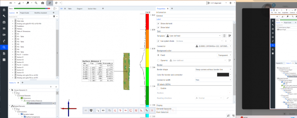

[Vi...] Posted July 29, 2023 Author Share Posted July 29, 2023 Dear Nanno Muehl, Thanks for your support. I see in the software there is this tool, but I don't know how to link this data to the table. Link to comment Share on other sites More sharing options...
