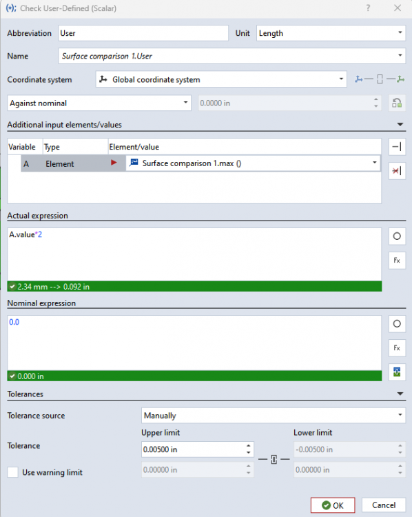

I have not done this from a surface comparison previously but have used the User Defined function, set my Max Label as a variable, then times that variable by 2 to get a surface profile. It appears it works with surface comparison as well. However, it not being a surface I'm sure there's less math that goes in which makes it quicker, my assumption.

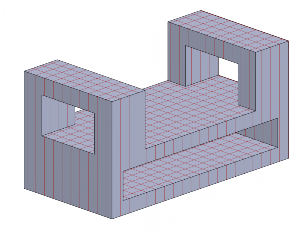

As we have a general surface call out on most our parts and a majority being complex we have found Surface patch from CAD to take quite a bit of time to generate. To combat not being able to "filter" how many points have been taken into account I have been manually adding points in, creating an element group, from that element group finding DN Max Deviation, and then doing the same user defined function as shown above. This somewhat represents what we would do with a CMM by touch probing many points however much quicker.
Also, until today I was manually clicking points all over parts as the Surface Points Evenly function does not work very well for 3D parts or surfaces on many levels, seems to select by a "View" and not by CAD surface like our other software. Instead, I found that creating Multisection Parallel on surface that are unspecified, neat tip you can restore point selection of the nominal geometries you selected then invert selection to get those quickly without clicking on them manually.
After you have those sections created you can do Vector Points On Section/Edge which will create equally spaced points on every line, give those the search radius and method you'd like, and repeat the same element group and reporting method as stated above.

awesome post, thank for those ideas, I'm not sure they apply much to me, but I will definitely keep those ideas in mind. I like how you incorporate the user defined to get a toleranced output. It's hard to learn that area in the software alone, once I began doing some python programming did I finally understand it well.
