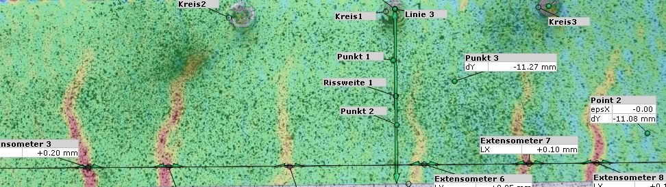

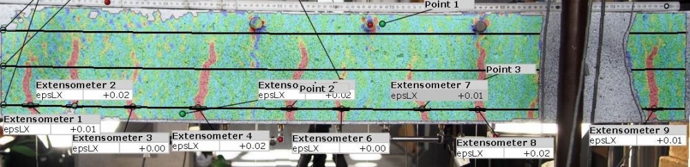

Hello there,
I am working on measuring some cracks with the help of the extensometers. In my calculation, I wanted to arrange the cracks' data from the middle of the specimen. Since the middle was not properly marked during the experiment, I am just drawing a line near the middle (approximately) and also manually measuring each crack distance with it. I was wondering if there is any option or way in the software that can help me find the middle of the specimen and show the crack distances from the center.

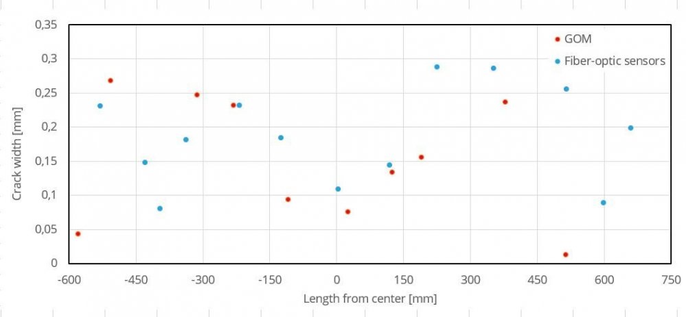

As you can see from the picture above the middle should be around point 1. And the graph below is how i want to represent my analysis.Capture.thumb.JPG.78dc8e9e2ed65f38092af22f3bc99c3a.JPG
I would really appreciate some tips and help. Thank you in advance!
Hi kleo,
some ideas:
  • use a fitting point over whole surface component to get the center of gravity (maybe not as good as you have missing data on the right)
  • or (maybe the easiest way):
    • select all points of component
    • create plane - fitting plane
    • create a point on the plane (center is automatically chosen)
  • create a scripted point and use the bounding box of the surface component as base
Hope this helps,

Hi Thorsten,
Thank you very much for your help. I managed to find the center of the specimen. The other issue is measuring the crack distance from it. Is there another way except from the 2 point distance, which has to be done for each extensometer one by one?
Thanks again,
Kleo

Hi kleo,
if you want all distance values you have to create and inspect all the distances to the extensometers.
But maybe this little script helps. 😉
