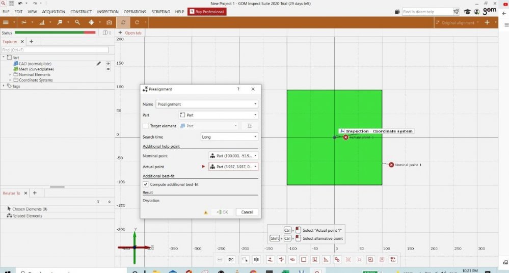

[Pa...] Posted July 27, 2021 Share Posted July 27, 2021 I want to compare surface comparison of Normal square plate (200X200 mm) and Curved plate. I uploaded the .stp model of Normal square plate and .stl format of curved plate. But, I am facing Error: MCADTrafo - 0002. Could you assist - How to resolve it Link to comment https://qualityforum.zeiss.com/topic/325-surface-comparison/ Share on other sites More sharing options...
[Be...] Posted July 27, 2021 Share Posted July 27, 2021 Hi, if your actual and nominal data is already aligned, you can call 'Define original alignment as initial alignment'. Otherwise you have to choose a different alignment strategy, e.g.: '3-points alignment' and an additional 'Local Bestfit' A 'Prealignment' needs a unique shape with curvature, a squre plate is usually not suitable for such kind of alignment. Last hint: If you only want to do a comparison against a plane, you can construct a plane and call Inspection -> Deviation to geometry Hope this helps?! Regards, Bernd Link to comment https://qualityforum.zeiss.com/topic/325-surface-comparison/#findComment-936 Share on other sites More sharing options...
