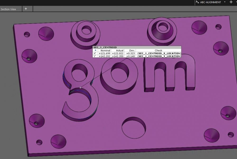

[Ja...] Posted October 12, 2023 Share Posted October 12, 2023 A question or kick off of a discussion topic ! When using line profile i know the fitting goes on in the background, but is there a possibility to show the location of the fit? Right now you calculate line profile , get the result and colours , but it causes a lot of confusion when overlayed to the nominal section. . The expectation is that in the profile visualisation there would be a properties option that allows to see calculated fit position , or similar. I hope this makes sense as i cannot describe the exact situation nor share the project... Cheers James Link to comment https://qualityforum.zeiss.com/topic/3318-surface-profile-representation/ Share on other sites More sharing options...

[Ja...] Posted October 17, 2023 Author Share Posted October 17, 2023 Hey Bernd , Thanks for the reply. The colour is helpful if you know what is going on , but the scenario is that the section visualisation in its (datum) alignment shows a material off condition in an area , however the line profile shows red in that same area indicating material on. for other engineers who consume the reports they dont know the software intimately and so the confusion/questions then follow that if the colours are somehow inverted , if the fit is correct, what the fit is doing , what am i interpreting etc. the only workaround is to write some words with the report to attempt to describe the output and remove the ambiguity, which is not so easy. thanks for adding the swreq, feels like old times 😉 Cheers James Link to comment https://qualityforum.zeiss.com/topic/3318-surface-profile-representation/#findComment-9155 Share on other sites More sharing options...
[Ti...] Posted October 17, 2023 Share Posted October 17, 2023 (edited) Please sign in to view this username. James, I'm updated a lot of our programs for many surface profile shapes. What I do is create a section cut, doesn't have to be complete, but needs to be symmetrical. Then you do a Construct Point > Centroid of Section . And then output the XY of that point. I find form and size are 10-20% of the out of tolerance profiles, so location is paramount. This process is working for us and I have correlated with a CMM and vision system enough times and seen it work enough to be confident in its ability to get the location of the profile. Some features that are deep or could have tool deflection I do multiple layers. Please sign in to view this username. The color map doesn't help us because many machinists need values to push features around and b/c many of our out of tol profiles have nothing to do with form/size, it is all about XY values for locating a feature/surface. Edited October 17, 2023 Link to comment https://qualityforum.zeiss.com/topic/3318-surface-profile-representation/#findComment-9157 Share on other sites More sharing options...

[Ti...] Posted October 19, 2023 Share Posted October 19, 2023 (edited) Please sign in to view this username. Discussing vague CAD stuff can be tough. I decided to use the GOM training part to explain my vision to get a location of a profile based on a best-fit(ie. no datum). I'll try to explain the pictures attached... pic 1 shows the centroid of the G location based on the bottom left corner of the part datum setup...I used the top plane, front plane, left plane for the DRF(datum reference plane). pic 2 shows a section of that feature in that DRF pic 3 shows where I locally best fit that section and the result... pic 4 shows where I used the most robust and largest features to generate a DRF(coordinate system) so I could establish an X and Y location of the centroids pic 5 shows the established locally best fit coordinate system(DRF) that you can use to extract the XY location of the two centroids. There are more things you would have to do, and perhaps tap into the User Defined section of the software, but this is what I would do to get the distance from the centroid of the section cut in a best fit oriention. ....to get "location" of a best fit you still must somehow establish a coordinate system. Maybe I still misunderstand your issue, but I thought I'd share this...would still like to connect with you remotely..can't hit you up on linkedin due to maybe your settings disallowing outsiders to contact you. Edited October 19, 2023 Link to comment https://qualityforum.zeiss.com/topic/3318-surface-profile-representation/#findComment-9171 Share on other sites More sharing options...
