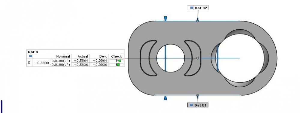

Linear size. Is there a way to separate Min/Max size or only report out one measurement?
In the attached image I've used a symmetric plane to report out size. I understand the standard in reporting out the Max and Min to consider the entire envelope. However i'm only interested in the max size in this case. Is there a way to only report out the max?

To seperate min and max, select the linear size element, then go to Inspection -> Check Dimensions -> Other -> User-Defined..
Under "Actual Expression" type inspection followed by a dot: inspection.
When you type the dot, a context menu should open. In the menu select Results -> result_dimension_min_max -> min -> measured value
This will give you the minimum value in a separate element. For the max value repeat the above, but select max.
