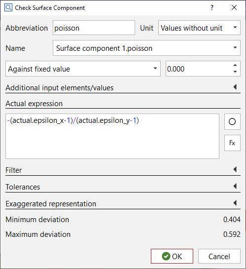

I am just using the GOM Correlate to do the deformation analysis of the tensile test experiments.  In the GOM Correlate, we can get the Epsilon(x) and Epsilon (y), how to get their ratio directly, I want to know the plain distribution of the Poisson ratio.

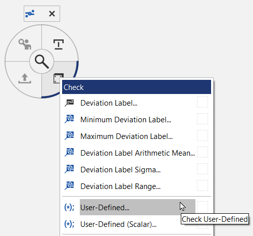

you can create a User-Defined-Check for your purpose. Please keep in mind, that the stretch ratios are delivered via the tokens used there.
