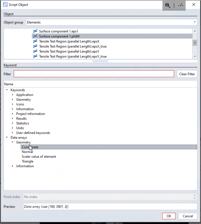

Dear all,
i am trying to export surface component on which von Mises strain is shown as a CSV file. For that I want to use a script. Under script objects I can see my surface component (Fig1). It shows that it is a  Data array (size [160, 5901, 3]). However, if I try to access this array in the script I get only NaN (see Fig2). Why does it show as NaN?
Further observations: What I am figuring is the contents of the array is:
160 - nr of stages
5901 - my surface component points
3 - coordinates of each of those points
Furthermore, the shape of "Scalar value of element" in Fig 1 is Data array (size [160, 5901, 1]). This suggests that each of the x,y,z, points has von Mises strain associated. But I am not able to access these as well - also showing as NaN.
All the best,
Thanks
Dear Mr. Saarna,
I'm not an expert in this field, but my guess is that there simply are no valid computation result for the selected points.
I tried a this with a different project and got similar results:

For the first point (#0), only the first two stages contain valid data. For the second point (#500) all stages contain valid data.
