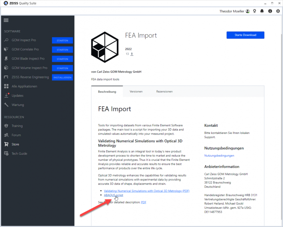

[Ko...] Posted September 18, 2023 Share Posted September 18, 2023 hello all, where can i find the scripts for donwload? Link to comment Share on other sites More sharing options...
[Th...] Posted December 14, 2023 Share Posted December 14, 2023 Please sign in to view this quote. Hi, I attached it to my last post right underneath the screenshot. Is the file not provided in your view of this page? As you can see in the screenshot in my last post you can get it from ZEISS Quality Suite in "Store". Search there for "FEA Import". Look in the description of the FEA Import package. The script is provided here Attachments - FEA Import - GOM Platform - GOM Connect, too. Link to comment Share on other sites More sharing options...
