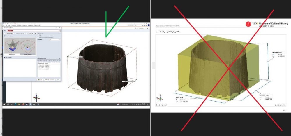

[Bj...] Posted December 5, 2023 Share Posted December 5, 2023 Exhibition designers want exact measurements of objects. Made a box around, but with a fair amount of work.... Then I tested Photorealistic rendering and chose light setup in a different context and voila, this box came around the object. Question... How can I make one like that easily with measurments like the other. See picture Link to comment Share on other sites More sharing options...
[Lu...] Posted December 6, 2023 Share Posted December 6, 2023 Hi Bjarte, if you just want a "simple" measurement of length, width and height of your object, you can use a Outer Caliper (Construct -> Distance -> Outer Caliper) in X, Y and Z directions. The radius of the probing disc should be large enough and you have to select two points at both "ends" of your object. Unbenannt.mp4Fetching info... I hope this helps in your case. Best regards, Lukas Link to comment Share on other sites More sharing options...
