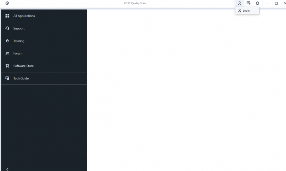

[Na...] Posted December 7, 2023 Share Posted December 7, 2023 I am facing an issue with zeiss login.So, i have zeiss quality suite and i can see the all applications but whenever i try to click login option , it doesn't show up anything and in connection page in network mode it is showing red color x symbol.So, could anyone suggest the solution please? Link to comment Share on other sites More sharing options...
[Ja...] Posted December 14, 2023 Share Posted December 14, 2023 I'm having a similar issue where Zeiss Quality Suite logs off and the login dialog becomes a blank screen. Even if you close and restart Zeiss Quality Suite the login widow is a blank screen. I found if you close the Zeiss Quality Suite using End Task in Task Manager and relaunch the application it will work correctly again. Link to comment Share on other sites More sharing options...

[Cl...] Posted January 17, 2024 Share Posted January 17, 2024 IT fixed our firewall problem, but I still get the blank screen when I click log in. I ended the program with task manages and still can't get pass the blank screen when I click log in. Any suggestions how to fix this? Link to comment Share on other sites More sharing options...

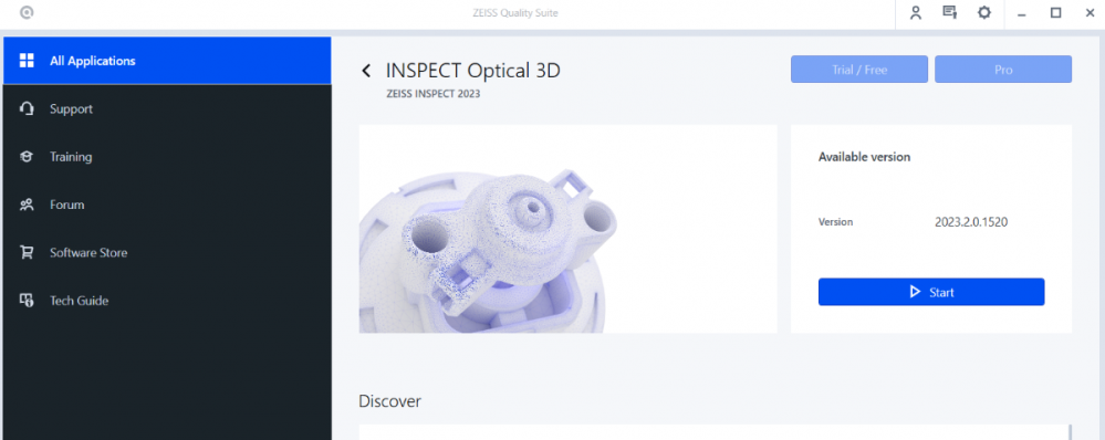

[Cl...] Posted January 17, 2024 Share Posted January 17, 2024 I was able to log in. Now It keeps asking for registration and the options for free trial or Pro are shaded. Do you know how to fixt this? Your help is greatly appreciated. Link to comment Share on other sites More sharing options...
[St...] Posted January 18, 2024 Share Posted January 18, 2024 If the button is blank like yours, it means that you need to be loged in. As you can see on the top right the account name is not showing. Link to comment Share on other sites More sharing options...

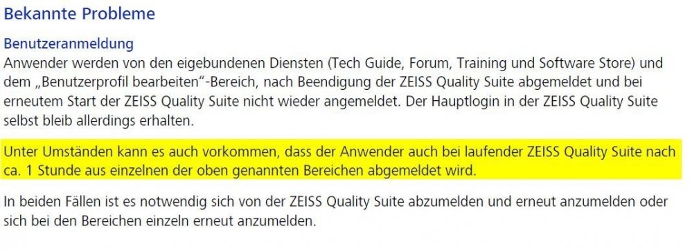

[Ax...] Posted February 9, 2024 Share Posted February 9, 2024 There is still a problem with the login: I am logged in to the Suite, but now I have to log in to the Forum, Techguide, Software Store and Training Centre every day. I have to log in to each individual section. I don't have to use all the sections every day, but I do check the forum every day and always have to log in separately. This morning I logged into the forum and was kicked out again after a few hours.There is still a problem with the login: I am logged in to the Suite, but now I have to log in to the Forum, Techguide, Software Store and Training Centre every day. I have to log in to each individual section. I don't have to use all the sections every day, but I do check the forum every day and always have to log in separately. Link to comment Share on other sites More sharing options...
[He...] Posted February 9, 2024 Share Posted February 9, 2024 Hallo, ja, ist bei mir auch... Steht auch genauso beschrieben in den Release Notes: Link to comment Share on other sites More sharing options...
