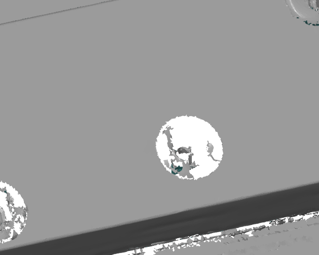

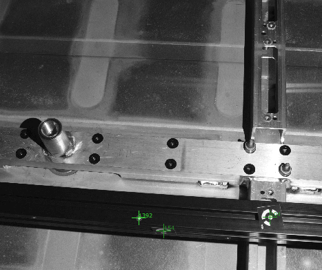

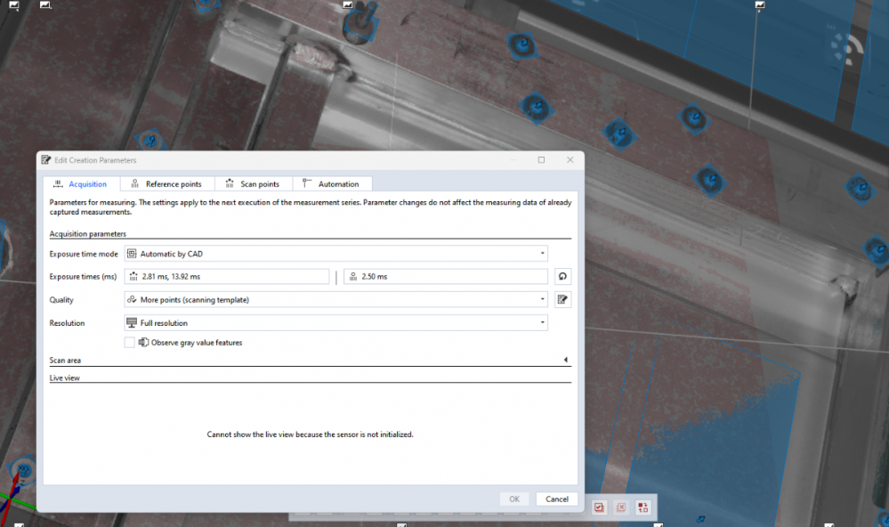

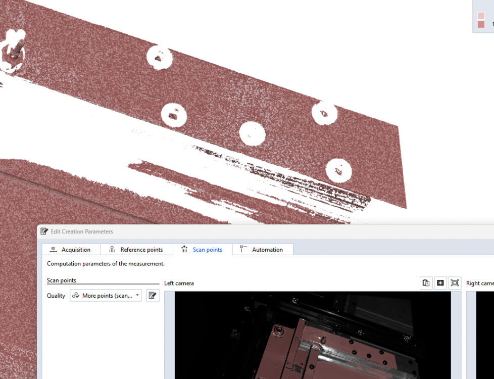

I am measuring a battery pack case with a scanbox.

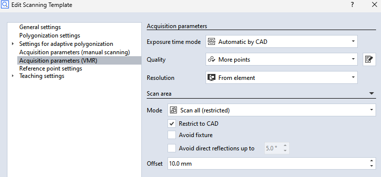

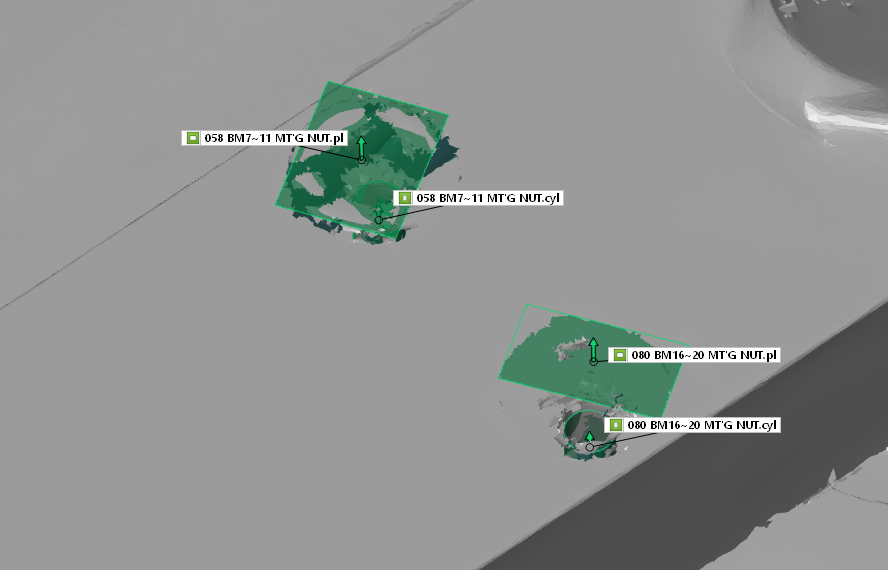

However, the VMR default setting of Exposure time:Automatic by CAD does not properly recognize the exposure time of a small area.
Automatic by CAD mode ignores the brightness of small areas.
Applying HDR+ to all elements takes too long and is heavy data.

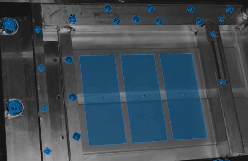

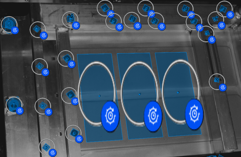

Currently After Smart Teach, the user manually changes the brightness of some created positions to HDR+.
This solution is cumbersome.

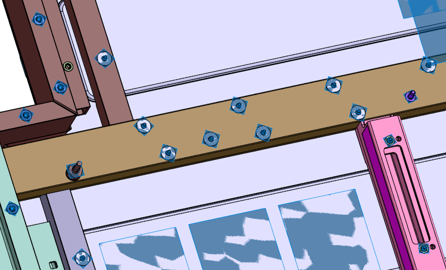

I wish there was a setting to adjust the exposure time for just the tagged Elements area, like in the photo below.
ex) Exposure time mode: Automatic by Element
