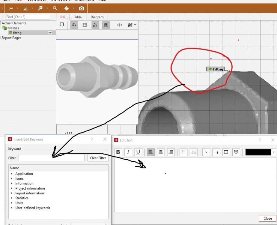

[An...] Posted December 23, 2023 Share Posted December 23, 2023 Please tell me what keyword gives the name of the STL file that is used in the report? Link to comment https://qualityforum.zeiss.com/topic/3510-the-name-of-the-stl-file-in-the-report/ Share on other sites More sharing options...

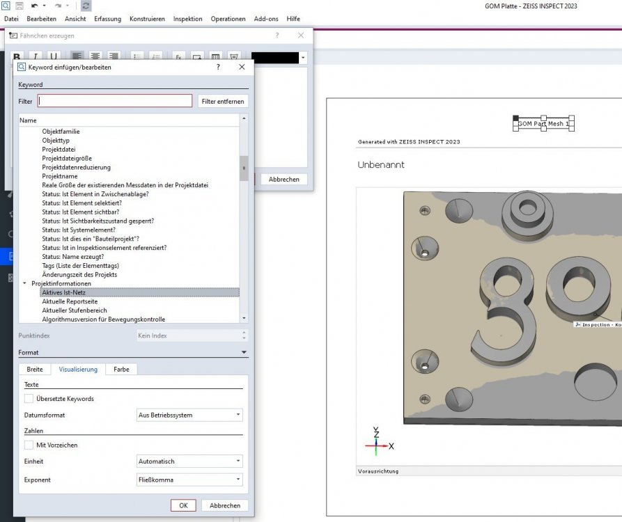

[Je...] Posted December 29, 2023 Share Posted December 29, 2023 Hello Andres, see attachment Best regards, Jens Link to comment https://qualityforum.zeiss.com/topic/3510-the-name-of-the-stl-file-in-the-report/#findComment-9892 Share on other sites More sharing options...
