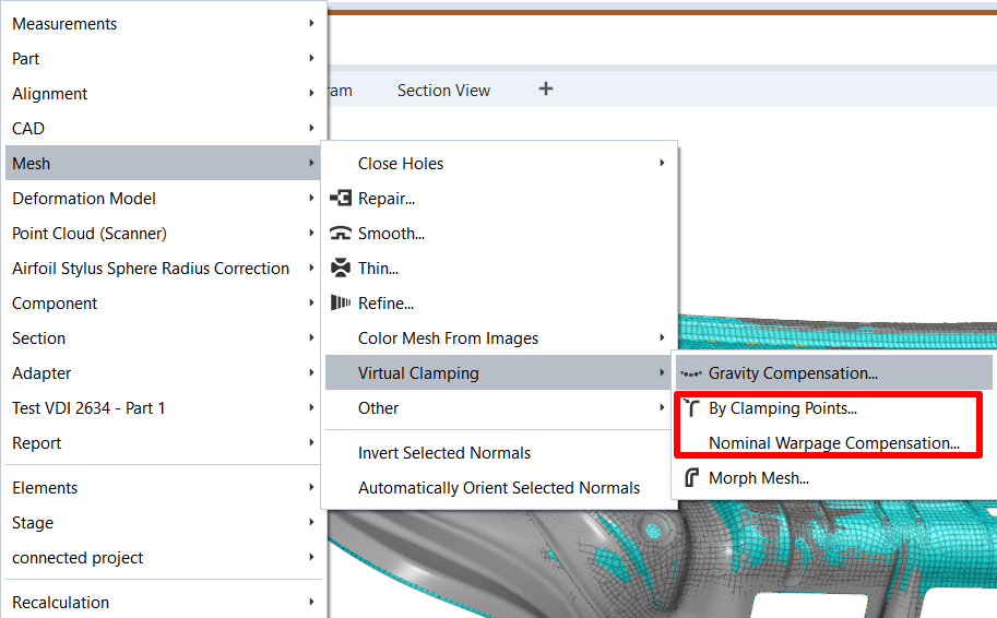

[Th...] Posted January 9, 2024 Share Posted January 9, 2024 "Nominal Warpage Compensation" is a Beta functionality that generates an deformed CAD (STL). Its can be used for compensation of part deformation during the 3D printing process. Workflow: Print a part --> analyse the deviation between initial STL and actual scan data --> generate the overcompensated STL --> print again. It can be that some iterations of this workflow are necessary. "By Clamping points" deformes the actual data based on defined points and deviation between CAD and acual data. Link to comment https://qualityforum.zeiss.com/topic/3518-what-is-the-difference-in-features%EF%BC%88by-clampingnominal-warpage%EF%BC%89/#findComment-9972 Share on other sites More sharing options...
