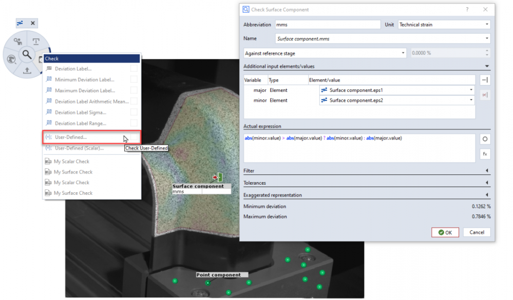

[Sh...] Posted January 8, 2024 Share Posted January 8, 2024 Hi everyone! I see that i can create major and minor strain fields with GOM. What I would like to have is a strain field with both - major and minor strain, while the maximum absolute value should be picked - like this: if abs(major strain) > abs(minor strain), choose major strain, else choose minor strain. I thought I could import a csv file after exporting both strain fields from gom as csv, and then just adjust the file. But I am unable to import the file. I appreciate the help! Link to comment Share on other sites More sharing options...
[Th...] Posted January 11, 2024 Share Posted January 11, 2024 Hello Shajia, you do not need to import anything, but can use the included functionality of the so called "user-defined-check": Hope this helps. Best regards, Thorsten Link to comment Share on other sites More sharing options...
[Sh...] Posted January 11, 2024 Author Share Posted January 11, 2024 Thank you Thorsten! This helped very much. Where do I find the explanations to the expressions? I did not know about the "?" and the ":". I removed the abs after the "?" and I got what I needed, as I want to keep the sign to compare it with my FE-Simulation! (I guess you speak German, you can answer in German as well) Kind regards Shajia Link to comment Share on other sites More sharing options...
[Th...] Posted January 18, 2024 Share Posted January 18, 2024 (edited) Hi Shajia, I'll stick to english, to perhaps reach more people. 😉 Glad to hear that it helped. 😃 There are no (real) explanations about the "regular expression" (as far as I know). You have to now... I'm not sure if you can find something in the training/ hack videos!? You could have acchieved the same with a "if-else-statement", but I liked this more (in this case) as it keeps things simple, short and clear. And in addition spreads this knowledge. 😉 Kind regards, Thorsten Edited January 18, 2024 Link to comment Share on other sites More sharing options...
[Sh...] Posted January 19, 2024 Author Share Posted January 19, 2024 Yes, the if-else-statements were also the first thing I wanted to try but I was lacking a lot of knowledge 😄 Your way helped a lot, thank you! Link to comment Share on other sites More sharing options...
