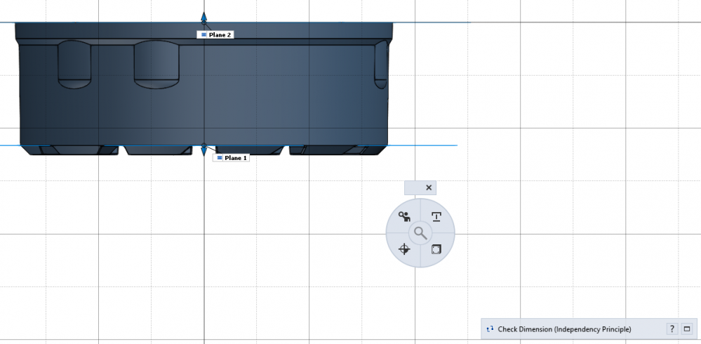

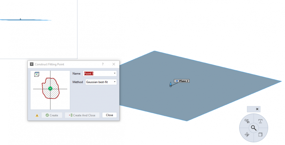

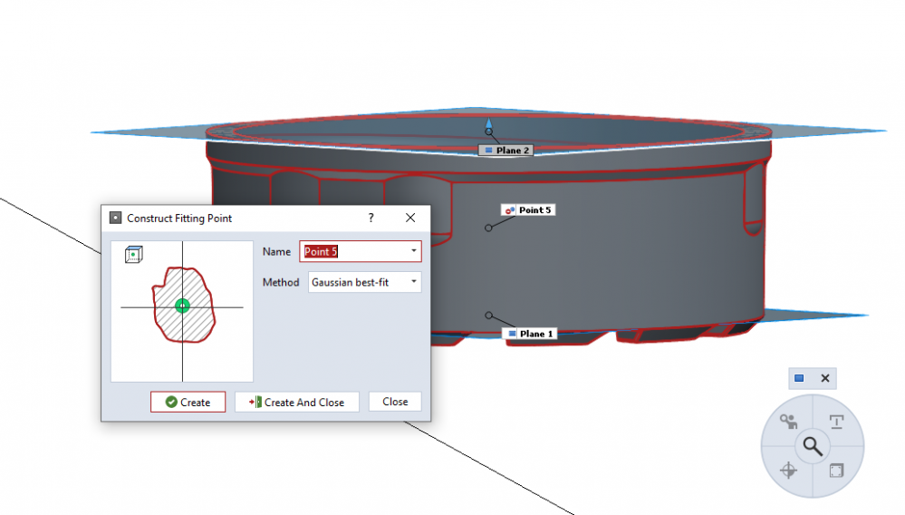

[Br...] Posted February 20, 2024 Share Posted February 20, 2024 Hi Lukas, could you please expound upon the above suggestions? Attempting "Option 1" above, I get stuck at the process below, which seems to be sort of an incomplete step, with no dimension to possible select, the i inspect wheel just seems to be locked at this point. In attempting "option 2" , I get no point, unless I pull up CAD, and "select all", then my point ends up in the middle of part, which is indicative of simply mid-point of the part, independent of the plane altogether. Link to comment Share on other sites More sharing options...
[Lu...] Posted February 21, 2024 Share Posted February 21, 2024 Hi Brian, to option 1: You need to create a symmetric plane between plane 1 and plane 2, via Construct -> Plane -> Symmetric Plane. You can then check this plane for a linear size using the I-Inspect in the GD&T area. to option 2: You select a plane, with RMB you select Restore Point Selection, then you construct the fitting point. The measurement principle of the fitting point must be Referenced construction. Then you get an Actual Fitting Point on your Actual plane. Do the same for the other plane. You can then determine the distance in a specific coordinate direction. Option 3: You take one of the two fitting points and create a perpendicular (Construct -> Distance -> Projected Point Distance) on the other plane. Then you have evaluated a perpendicular distance. Best regards, Lukas Link to comment Share on other sites More sharing options...

[To...] Posted October 23 Share Posted October 23 Hi Lukas, How do you select the points from your plane? I tried highlighting my plane, then opened a fitting point hoping the software would use the plane for the fitting point creation but it didn't work. I'm new to Zeiss Inspect so any help is appreciated. Thanks! Todd Link to comment Share on other sites More sharing options...
[Ma...] Posted October 23 Share Posted October 23 Please sign in to view this username. Hi, from what i read and tried you can do this. Go to Menu -> Construct -> Point -> Fitting point Now right click with mouse on nominal plane and select "Restore selection" -> now you should be able to click "Create" Now just select measuring principle as "Construction with refference" Link to comment Share on other sites More sharing options...
[To...] Posted October 23 Share Posted October 23 Thanks Martin. That worked!😁 Link to comment Share on other sites More sharing options...
[Ma...] Posted October 23 Share Posted October 23 Please sign in to view this username. Let's clear it for others. For obtaining nominal point you have to see only nominal model and you can click on Restore point selection. Same thing you can do with measured data -> show only mesh, and click on measured plane and do Restore point selection ( now you don't need to select measurement principle ) Both methods will give you sligthly different numbers. I was playing with measuring thickness with this - i got 3 different numbers with 2point distance on nominal, measured and distance on symmetry plane. But even for forged, sandblasted part i got difference in a 0,02-0,03mm. Link to comment Share on other sites More sharing options...
