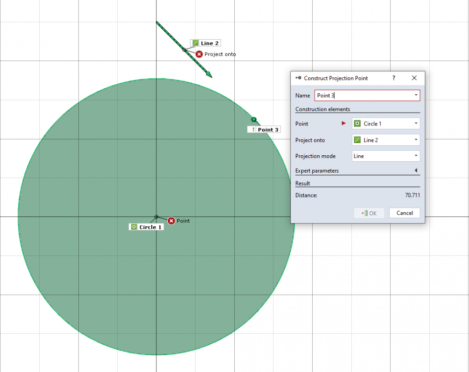

[Ti...] Posted January 31, 2024 Share Posted January 31, 2024 I don't like having to resort to finding the tangency point of the intersection of a circle and line. There can be a situation that they do not intersect. What creative ways can we get this intersection point? Link to comment Share on other sites More sharing options...
[Mi...] Posted February 1, 2024 Share Posted February 1, 2024 You could use the command "Construct-> Point -> Construct Projection Point" to project the circle center onto the line. Link to comment Share on other sites More sharing options...
[Ti...] Posted February 3, 2024 Author Share Posted February 3, 2024 Thanks, I overlook that tool too often. I'll give that a shot. Thanks. Link to comment Share on other sites More sharing options...
