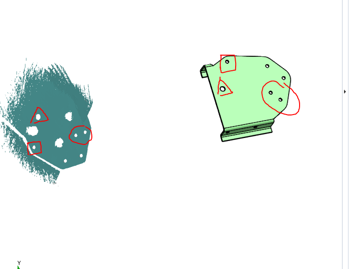

[Lu...] Posted February 7, 2024 Share Posted February 7, 2024 Hi Zeiss community! I need some help doing an alignment. I would like to compare this poorly scanned mesh with my cad model. I tried to use the alignment tool but I can not get it to an approximation. I thought of doing it by the holes, I know they are not exactly on the same coordenates, but just by aligning one or two I could get the difference. How could I do it? I also attach the .inspect in this link for any help. download link: https://www.mediafire.com/file/8r51vjcrgnmdhva/cad_mesh_align_hole.rar/file Thanks. Link to comment https://qualityforum.zeiss.com/topic/3637-how-to-align-via-holes/ Share on other sites More sharing options...

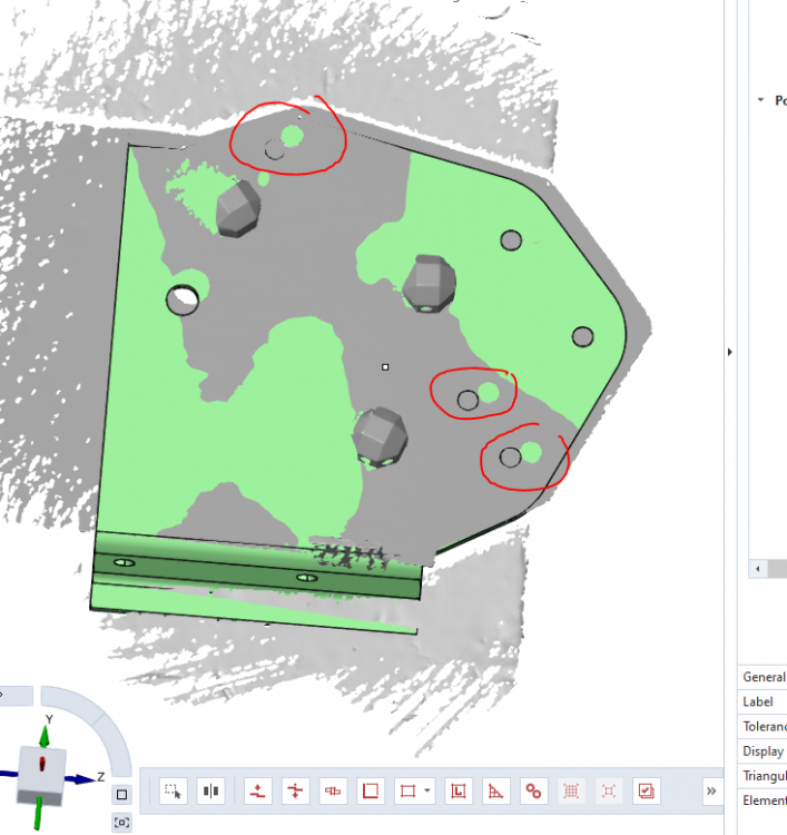

[Ja...] Posted February 7, 2024 Share Posted February 7, 2024 Its a little hard to see but it looks like you do not have any depth to the holes in your actual scan? You will need some depth here to even think about attempting an alignment by the holes. There could be crude ways of doing it by eye but this would be non parametric and not something id recommend as it isnt a regular workflow . Link to comment https://qualityforum.zeiss.com/topic/3637-how-to-align-via-holes/#findComment-10357 Share on other sites More sharing options...

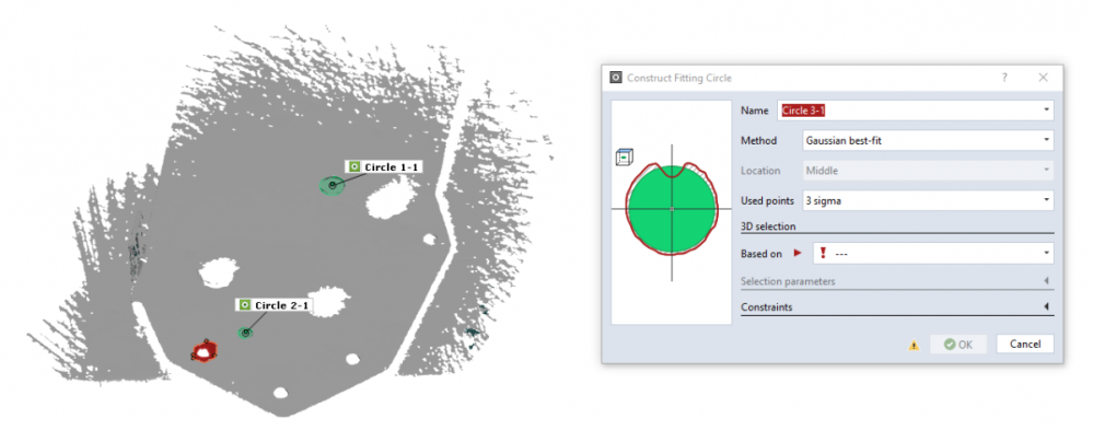

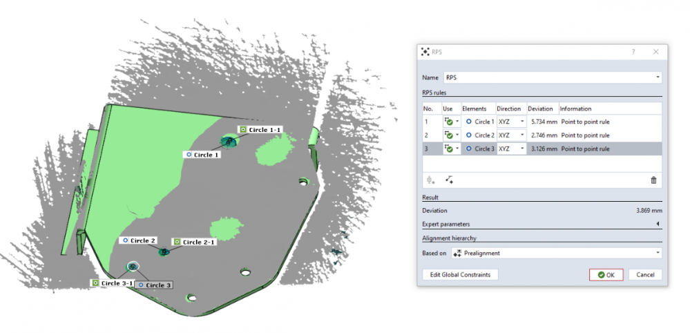

[Lu...] Posted February 8, 2024 Share Posted February 8, 2024 (edited) Hello Luis, the problem is that the actual data is too far away from the nominal elements and there is no data in the lateral orientation of the holes for the pre-alignment to work properly. If this is your only scan and you do not need the parametric, I recommend that you construct fitting circles on the actual data and link them to the nominal circles on the CAD. You can then try an RPS alignment. Best regards, Lukas Edited February 8, 2024 Link to comment https://qualityforum.zeiss.com/topic/3637-how-to-align-via-holes/#findComment-10362 Share on other sites More sharing options...
