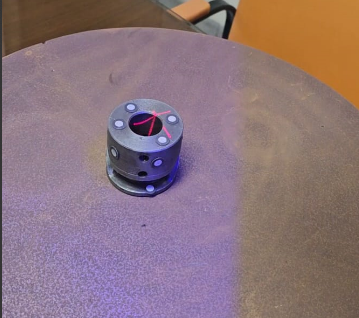

It's my first time scanning a small part so I wasn't able to set the targets on the part... But now I have a problem when trying to align the meshes.

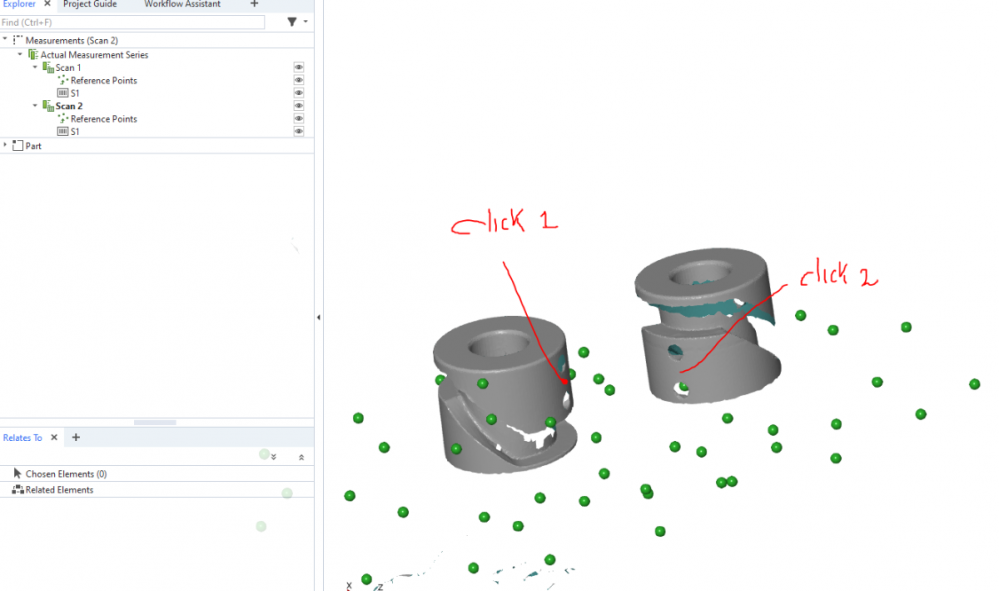

1) How can I align them when obviously the targets are not coincident because i flipped the part to scan both sides? I tried by ctrl+click on almost the same spots on the part and I couldn't do it.

image.png.a8d1e2d0dcc96d95197d479c4ad28641.pngimage.png.05897c67a5fb26bea0ad1e19dd4686af.png

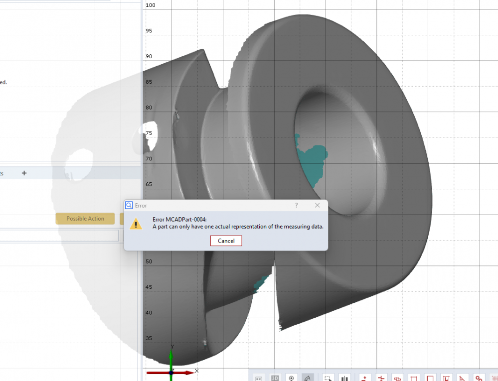

So i saw in YouTube that people scan both sides as separate files, export the .SRL mesh and then use the alignment tool..
I can only get this error when drag and dropping the meshes into the software...
Can someone help me?
image.thumb.png.66662b79ebd7e048f7fe9b1791721f19.pngI get
Hi Luis,
you need at least three reference points on the part, which are scanned in both measurement series. Here is the techguide article:
ZEISS Quality Tech Guide
The alignment of two parts will not give you a single polygonized mesh. (I think you added the imported mesh to the existing part instead of adding it to a new one, which results in the error).
Nanno

The hard part is that I have a cylinder, and I'm pretty sure I should not put any reference point along the curve, should I?

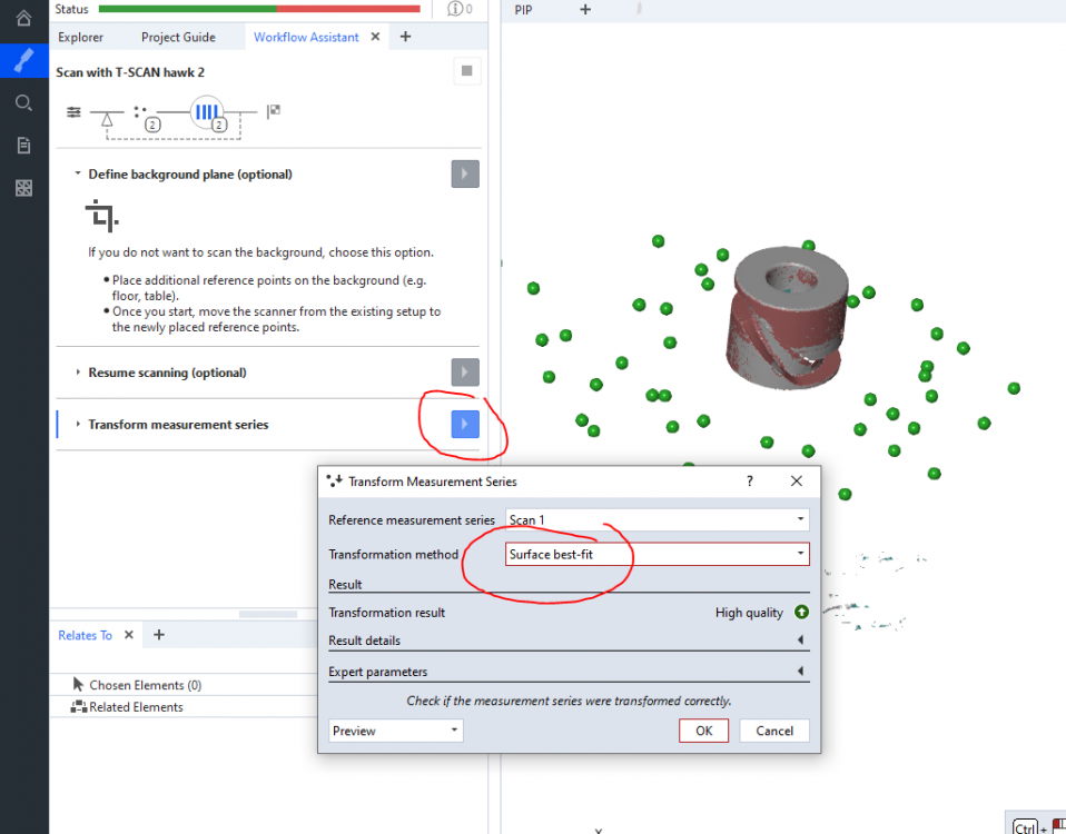

Also, I tried according to that guide the best-fit surface, but I have some trouble:

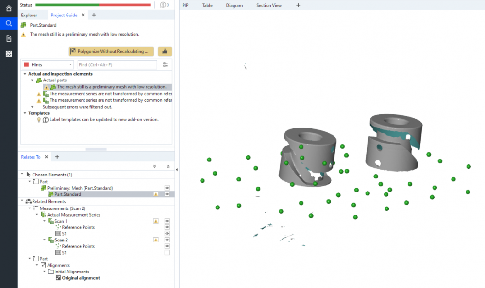

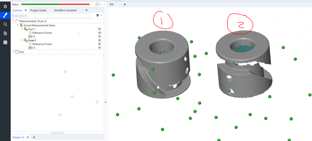

First i check both meshes are in the same project after doing the scan other side:

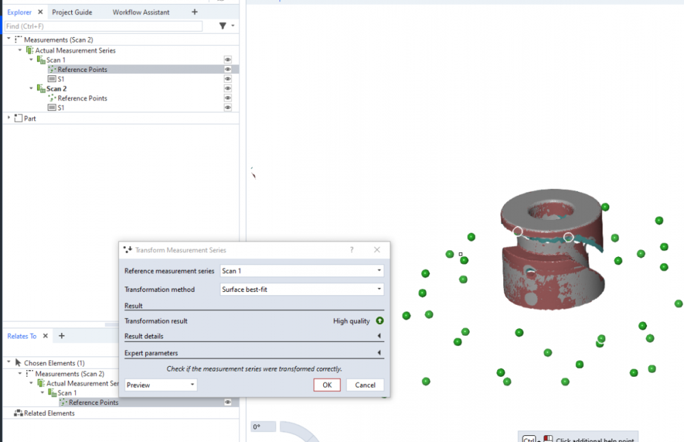

Then I go to the transform measurement series and select best surface-fit: I have a problem because both meshes move by itself and does not move in the correct way. I was thinking in clicking in a common part so the software tries to force the alignment in the points i click, but once i call the best surface option, the meshes moves and I can not click because they are one on top of another
Hi Luis,
the radius is large enough to put reference points on there. It's not perfect but should not be a problem. An alternative would be a reference point frame around the part (it must not move relative to the frame). The surface fit will transform via common surfaces on both measurement series. You can define points (on the surface, not referenece points) in the expert parameters but I recommend sticking reference points on the part.
