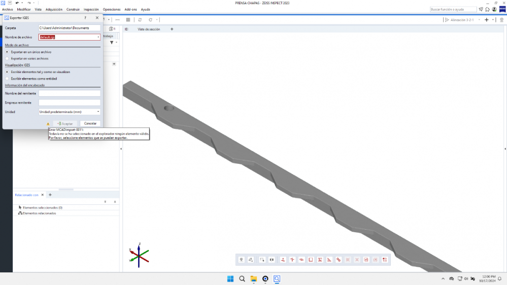

[RE...] Posted October 17, 2024 Share Posted October 17, 2024 HELLO, Im new user of software. I have problems to export in CAD(Iges, Step). How can i fix this problem? Thanks Link to comment Share on other sites More sharing options...
[Ja...] Posted October 17, 2024 Share Posted October 17, 2024 Please sign in to view this username. this isnt possible. The mesh generated by the software can be exported in stl only. In order to create cad from mesh you need reverse engineering tools. Sections through mesh can be exported as iges that can be useful to guide reverse engineering. Link to comment Share on other sites More sharing options...
