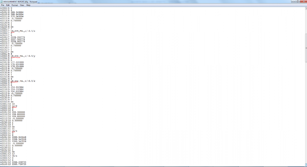

[EN...] Posted August 20, 2021 Share Posted August 20, 2021 I am using ATOSSCANBOX 5120.I want to extract data as QDAS.FILE/EXPORT/INSPECTION/QDAS.When I choose as, it selects and removes all the selected tolerances and elements in the program.I just want the can you help?Pictures are attached. Link to comment Share on other sites More sharing options...
[Da...] Posted August 26, 2021 Share Posted August 26, 2021 Dear Ender Calisir, exporting data in QDAS format does not allow the user to choose elements. Instead all elements which can be exported using the QDAS format will be automatically selected and exported. Regards, Daniel Schrein Link to comment Share on other sites More sharing options...
[Da...] Posted August 26, 2021 Share Posted August 26, 2021 Dear Ender Calisir, a solution would be to create a report page with the desired checks and export the file using FILE -> Export -> Report -> Inspection -> QDAS and select the report page you want to export. Regards, Daniel Schrein Link to comment Share on other sites More sharing options...
[EN...] Posted September 4, 2021 Author Share Posted September 4, 2021 Hi Daniel Scherin, Extracting it as a report solved our problem. Is there a solution for this, while extracting the geometry, it's getting it mixed up? The picture is attached. Link to comment Share on other sites More sharing options...
