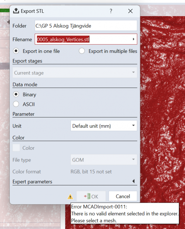

[La...] Posted March 19, 2024 Share Posted March 19, 2024 Hello! When I try to export as STL, I get the answer "Please select a mesh" (see below). How, please? (I have used GOM Inspect many years, never had problems with this before.) Link to comment Share on other sites More sharing options...
[Na...] Posted March 19, 2024 Share Posted March 19, 2024 Hi, this function needs an element selection. You have to click on a mesh in the explorer. The red selection would be a point selection. Nanno Link to comment Share on other sites More sharing options...
[La...] Posted March 19, 2024 Author Share Posted March 19, 2024 Thank you very much for responding! But I have tried that. Is it the right place? Link to comment Share on other sites More sharing options...
[Na...] Posted March 19, 2024 Share Posted March 19, 2024 Hi, then I misunderstood because of the red mesh in the background. For STL export a (polygonized) mesh is needed. You can polygonize the point cloud via operation -> point cloud (scanner) or export the point cloud as ASCII for example. Link to comment Share on other sites More sharing options...
