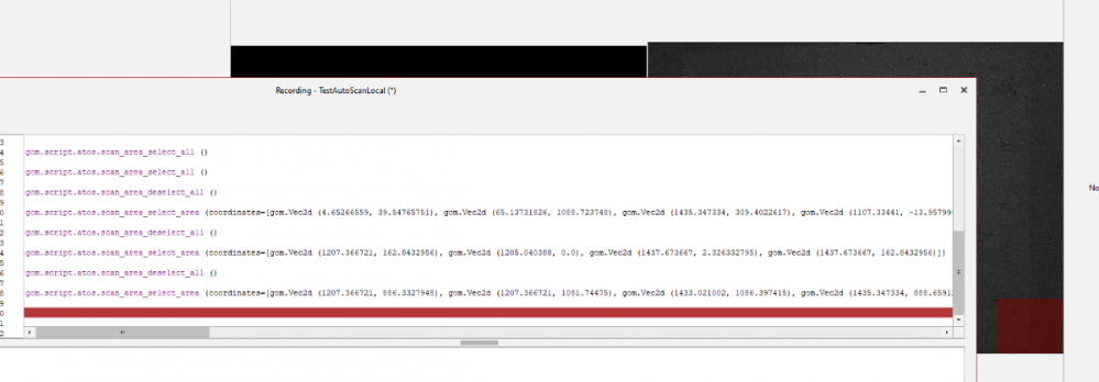

[Zi...] Posted August 27, 2021 Share Posted August 27, 2021 Hello, As we can define a scan area manually to avoid inter-reflexion, this can also be done with Python script with the function gom.script.scan_area_select_area(...), however I found the resoution of the full area is not constant, it seems to be around 912x684 for Atos Core 500 and 1438x1086 for Atos Q with the lenses MV270 (see figure attached), could anyone please confirm me the sizes for different lenses for Atos Q? Best regards Zilong Link to comment Share on other sites More sharing options...
[Ph...] Posted August 31, 2021 Share Posted August 31, 2021 Hi, scan area resolutions are depending on the used projection unit. The projection unit from the ATOS Core is different from the ATOS Q. ATOS Core: 912x684 ATOS Q: 1440x1080 Best regards, Philipp Kayser Link to comment Share on other sites More sharing options...
