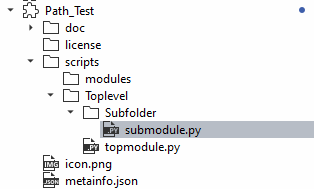

[Ma...] Posted April 12, 2024 Share Posted April 12, 2024 Hi, does it work to import a package using an absolute path? E.g.: # -*- coding: utf-8 -*- # submodule.py import gom from Toplevel import topmodule Regards, Matthias Link to comment Share on other sites More sharing options...

[Ma...] Posted May 3, 2024 Share Posted May 3, 2024 (edited) I have got it running, well at least it runs until the "Start Menu"-dialog with the "Prepare Measurement"-button, so it looks like all imports are working here. Sorry, I cannot test this further, no equipment ready... What have I done: 1) Move start scripts out of the "Kiosk" package: and adapted the imports to use relative imports into the "Kiosk" package. There are two places, the one shown in the picture and in lines 113ff: def tryToImportStandardTest(name=""): try: exec('from Kiosk.StandardTests import %s' % name) 2) Adapt the imports in the "Kiosk" package to use relative import from ".", for example in Basetest.py: # import from standard system scripts: from . import Functions from . import Dialogs from . import Variables There are about 10 imports in the toplevel scripts in "Kiosk". I hope this helps and that it's also working for the complete workflow. Edited May 3, 2024 Link to comment Share on other sites More sharing options...
