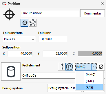

[Fe...] Posted April 17, 2024 Share Posted April 17, 2024 Hi at all! I would like to ask you how to display only the position tolerance with cmm and not also the normal one? (In PiWeb) I attach an image where I highlight the quota to be removed in case of position with cmm. Thank you!! Link to comment https://qualityforum.zeiss.com/topic/3891-position-tolerance-with-cmm-in-piweb/ Share on other sites More sharing options...
[Sp...] Posted April 18, 2024 Share Posted April 18, 2024 Hello, you need to select RFS in the Calypso characterstic settings - Christoph Link to comment https://qualityforum.zeiss.com/topic/3891-position-tolerance-with-cmm-in-piweb/#findComment-11285 Share on other sites More sharing options...

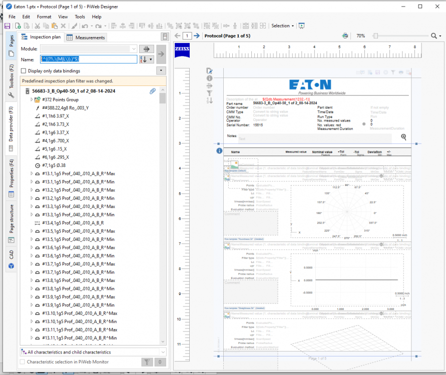

[Ri...] Posted January 3, 2025 Share Posted January 3, 2025 (edited) You have to add this string to the "Data Provider" tab in PiWeb. {^((?!\.\(M|L\)).)*$} I don't have the exact instructions; you can search on this forum to find them. Found the link. ZEISS Portal Edited January 3, 2025 Link to comment https://qualityforum.zeiss.com/topic/3891-position-tolerance-with-cmm-in-piweb/#findComment-123276 Share on other sites More sharing options...
