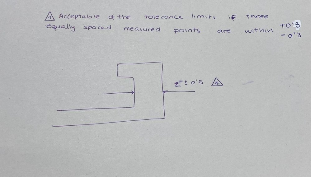

[Mi...] Posted April 17, 2024 Share Posted April 17, 2024 (edited) Good morning, We need to inspect a part against nominal CAD, but the drawing has some conditionality in a feature (see attached document). How is it possible to program this? Is there any possibility to program the tolerance limits like a variable? Thank you, Mikel Edited April 17, 2024 Link to comment Share on other sites More sharing options...
[Ja...] Posted April 18, 2024 Share Posted April 18, 2024 I think element group would be the way id approach this ask. Link to comment Share on other sites More sharing options...
