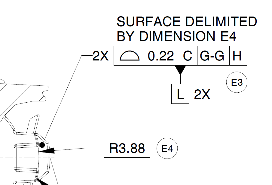

[Ki...] Posted April 18, 2024 Share Posted April 18, 2024 How would I go about doing this please? Link to comment https://qualityforum.zeiss.com/topic/3899-surface-profile-delimited-by-dimension/ Share on other sites More sharing options...
[Ki...] Posted April 22, 2024 Author Share Posted April 22, 2024 Hi All, I think I need to somehow only select part of the patch but I am unsure how to do that. otherwise I think I need to look at this another way? Can anyone help? Cheers, Kieran Link to comment https://qualityforum.zeiss.com/topic/3899-surface-profile-delimited-by-dimension/#findComment-11318 Share on other sites More sharing options...
[Na...] Posted April 22, 2024 Share Posted April 22, 2024 Hi, you may construct a circle or cylinder with the radius and use this element for a deselection. Select the whole patch, then deselect by geometry contour while you are in the creation dialog or edit creation. On the cad you are bound to your cad resolution, so you may have to perform this on the actual surface. Or you ask the constructor of the cad to include another patch 🙂 https://techguide.zeiss.com/en/zeiss-inspect-2023/article/cmd_selection3d_deselect_by_geometry_contour.html Nanno Link to comment https://qualityforum.zeiss.com/topic/3899-surface-profile-delimited-by-dimension/#findComment-11319 Share on other sites More sharing options...
