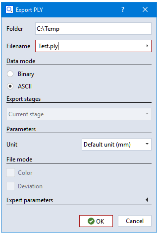

[Th...] Posted May 22, 2024 Share Posted May 22, 2024 Is there a way to export the point cloud, i.e. the scanned raw data, in a common format such as *.xyz, *.e57 or *.pcd from Gom Inspect? Link to comment Share on other sites More sharing options...
[Ha...] Posted May 23, 2024 Share Posted May 23, 2024 Maybe export to PLY format (Polygon File Format) in ASCII is usable for you. Link to comment Share on other sites More sharing options...
