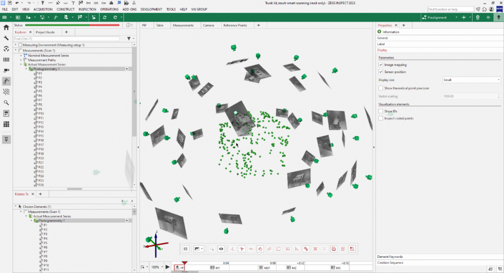

I'm looking for a way to export the camera location and rotation information for TRITOP image from ZEISS inspect for use in other visualization tools.
I haven't been able ti identify this from the standard menus, only export the images.
Is this possible through python scripting?

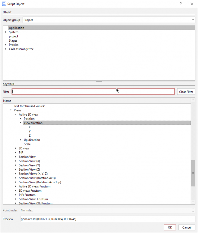

in a project with a nominal measurement series, the positions are defined by a gom.Mat4x4 matrix.

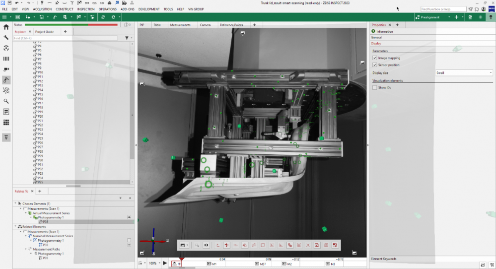

Without e.g. Tritop only, there is the position as a token in the script editor. The rotation could be retrieved by clicking into the image mapping -> R on keyboard for rotation and then by active view in the script editor. It is also possible to construct points on the camera symbols (tick sensor position in the measurement series' properties).

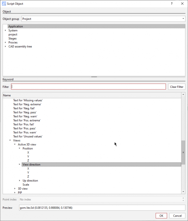

I've begun writing the script now.  I've not managed to find the position token for the images you mentioned, but I think extracting them from the view at the same time as the direction will work.
I (think) I am converting from the direction and image_up vectors to yaw pitch and roll, but the whole process seems a little clumsy.
Is there not a more efficient way to directly access this information without going via element-front view?
