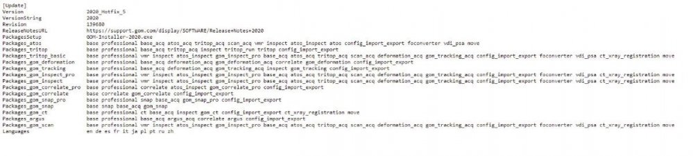

[Ph...] Posted September 14, 2021 Author Share Posted September 14, 2021 Hello Dennis, The OS is Windows 7. I have a virus scanner but I had it too last year and the Gom Update worked correctly. I'll will ask anyway to my Computer administrator for disabling the virus scan. When I open the address you gave me I got what you can see in the file attached. Thanks for your help. Link to comment https://qualityforum.zeiss.com/topic/403-gom-inspect-software-update-check-failed/#findComment-1256 Share on other sites More sharing options...
