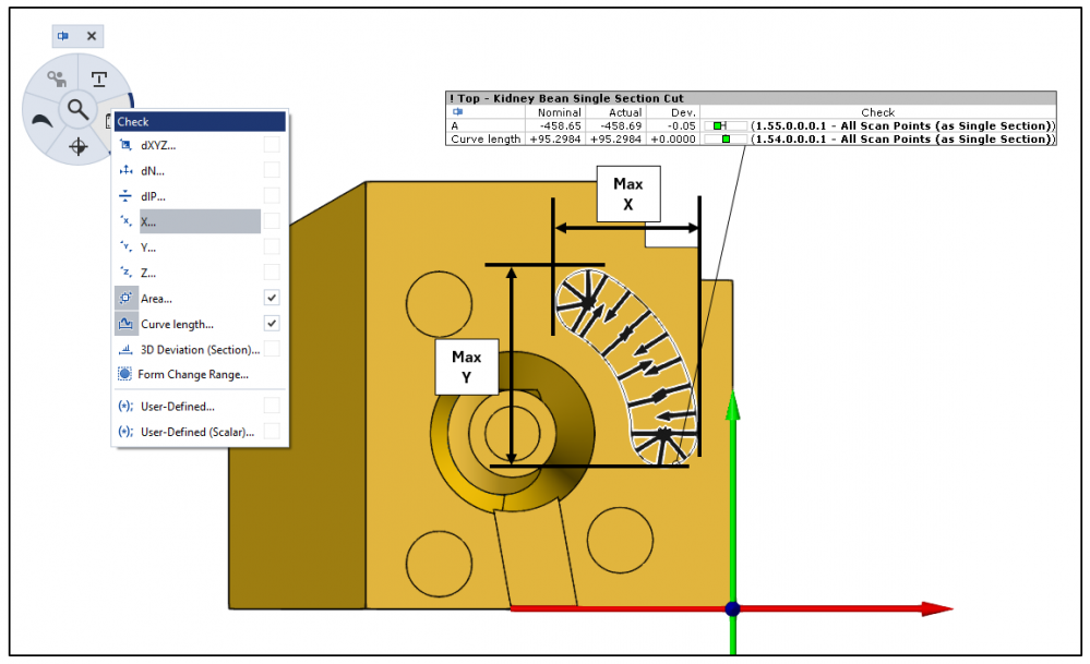

[Mi...] Posted June 19, 2024 Share Posted June 19, 2024 I made a single-section cut on my CAD model which resulted in this 'kidney bean' shape. I am able to measure the length and area of my curve, but I would also like to measure the maximum X and maximum Y distances across the extreme ends of the curve (as depicted below). When I select X... from the i-inspect wheel, I do not end up with an X-dimension for my curve. Instead I end up with some sort of Inspection element that falls under 'Curves - Dimension Deviations', and I do not know what to do with that information. I found a way to get the dimensions I would like by constructing 'Outer Disc Calipers' and by putting arbitrary points in space near the extremes of the my curve, but I feel this is a very poor way of finding the curve dimensions. Can someone point me in the right direction? Link to comment https://qualityforum.zeiss.com/topic/4059-x-and-y-distance-across-a-closed-curve/ Share on other sites More sharing options...

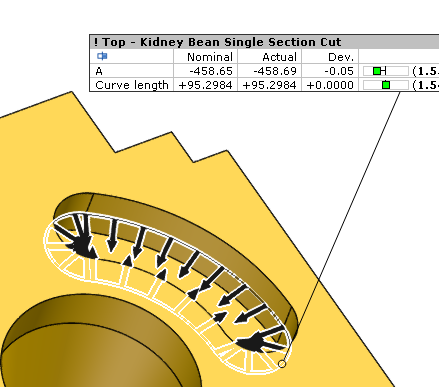

[Ja...] Posted June 19, 2024 Share Posted June 19, 2024 Hi mike is that curve projected onto that plane face or is there a recess there that you have created the curve around? Link to comment https://qualityforum.zeiss.com/topic/4059-x-and-y-distance-across-a-closed-curve/#findComment-11789 Share on other sites More sharing options...
[Mi...] Posted June 19, 2024 Author Share Posted June 19, 2024 Please sign in to view this username. The nominal element is a single section and is located 5mm below the top plane. Link to comment https://qualityforum.zeiss.com/topic/4059-x-and-y-distance-across-a-closed-curve/#findComment-11793 Share on other sites More sharing options...
[Ja...] Posted June 20, 2024 Share Posted June 20, 2024 Please sign in to view this username. I thought that must have been the case but just wanted to check!! A good option here is to set up surface points on this section, approximately such that their vectors are in x and y (can force them to be if you want) then use a measure principle of touch point edge making sure to select the actual section , setting the touch direction orthogonal to the checking direction. You can then take a distance to this touched maxima. I hope this makes sense! Link to comment https://qualityforum.zeiss.com/topic/4059-x-and-y-distance-across-a-closed-curve/#findComment-11797 Share on other sites More sharing options...
