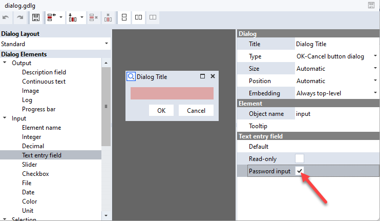

Insert hidden text for password
Hi, is there a way to hide text entry in a box in a window by scripting, such as hiding letters when entering a password?
Thank you
Hi,
Yes, in the Dialog Editor, you can check the property "Password input" of the "Text entry field" widget to achieve this:
As the result, a dot is shown for each input character:
