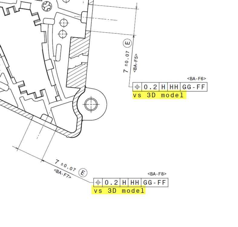

VS 3D MODEL
I would contact the engineer and ask the intent of the note.  My interpretation of this note is that the 3D model is to be used to obtain all the basic dimensions.
