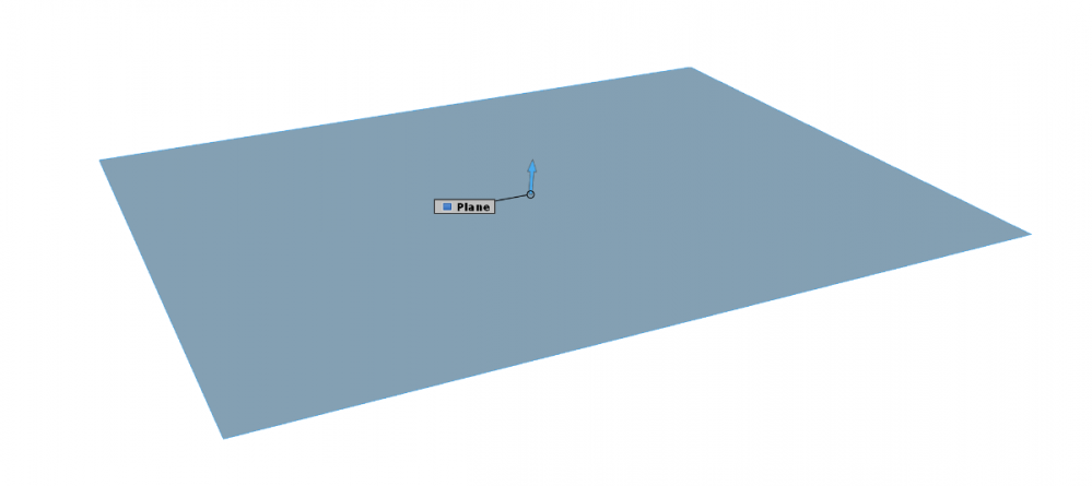

A plane is geometrically uniquely defined by a base point or support point on this plane and by a normal vector. The normal vector of the plane can be queried in scripting (plane.normal), but apparently not the point on the plane. Is that correct?
Or can the point be queried in the scripting? If so, how?

Hey Andreas,
I guess you are calling the normal with such an expression:
gom.app. ...['Plane'].normal
Please give a try with the same line, but calling the center coordinates instead of the normal:
gom.app. ...['Plane'].center_coordinate
-->  This is not part of the 'F2'-Script Object list, but it should work.
To double check this you can build a guinea pig:
  1. Build a plane
  2. Construct a point by clicking the plane name lable
  3. run a test
    print (gom.app. ... ['Point'].center_coordinate)
    print (gom.app. ... ['Plane'].normal)
    print (gom.app. ... ['Plane'].center_coordinate)
  4. Plane and Point center coordinates should be the same
Hope this helps! - Gruß, Jens
