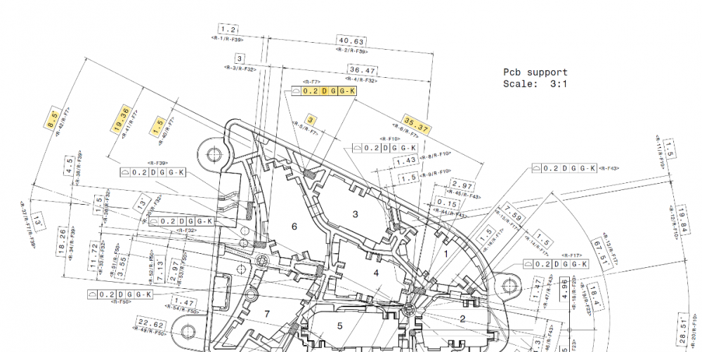

[DR...] Posted September 8, 2021 Share Posted September 8, 2021 HELLO ! Is It possible to measure the bellow profile of a surface with Gom ? Link to comment https://qualityforum.zeiss.com/topic/412-profil/ Share on other sites More sharing options...
[DR...] Posted September 8, 2021 Author Share Posted September 8, 2021 for exemple the profile number <R-F7> is related to dimension 35.37 & 3 & 1.5 & 19.36 Link to comment https://qualityforum.zeiss.com/topic/412-profil/#findComment-1206 Share on other sites More sharing options...

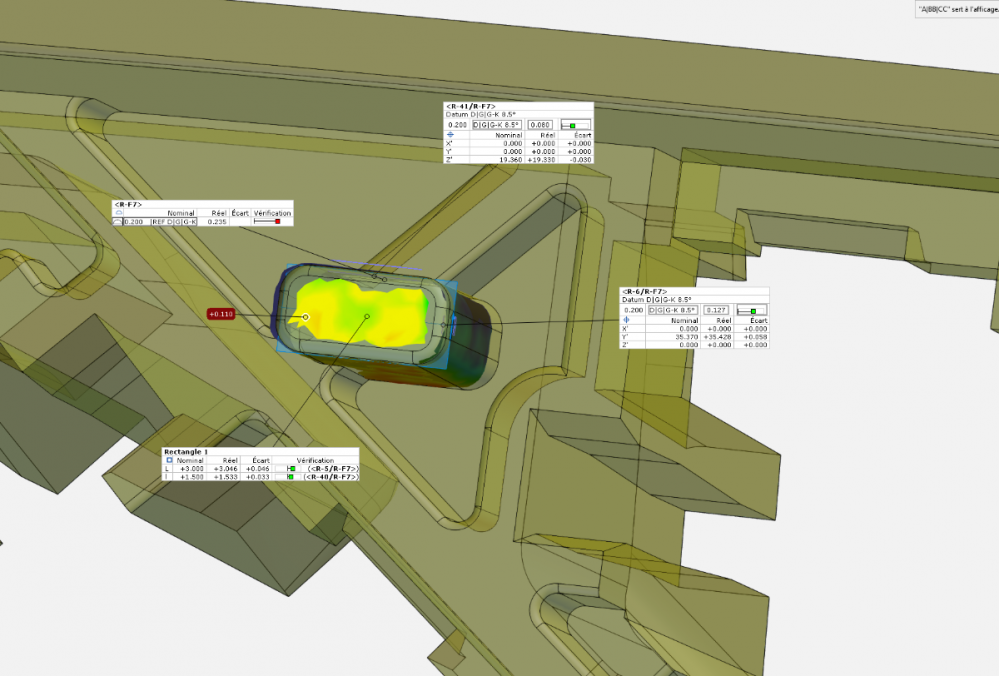

[DR...] Posted September 8, 2021 Author Share Posted September 8, 2021 the only think I can do , I take a rectangle (Rechteck) and I measured the localisation of his center . I can't select the profile option for that ... Link to comment https://qualityforum.zeiss.com/topic/412-profil/#findComment-1207 Share on other sites More sharing options...

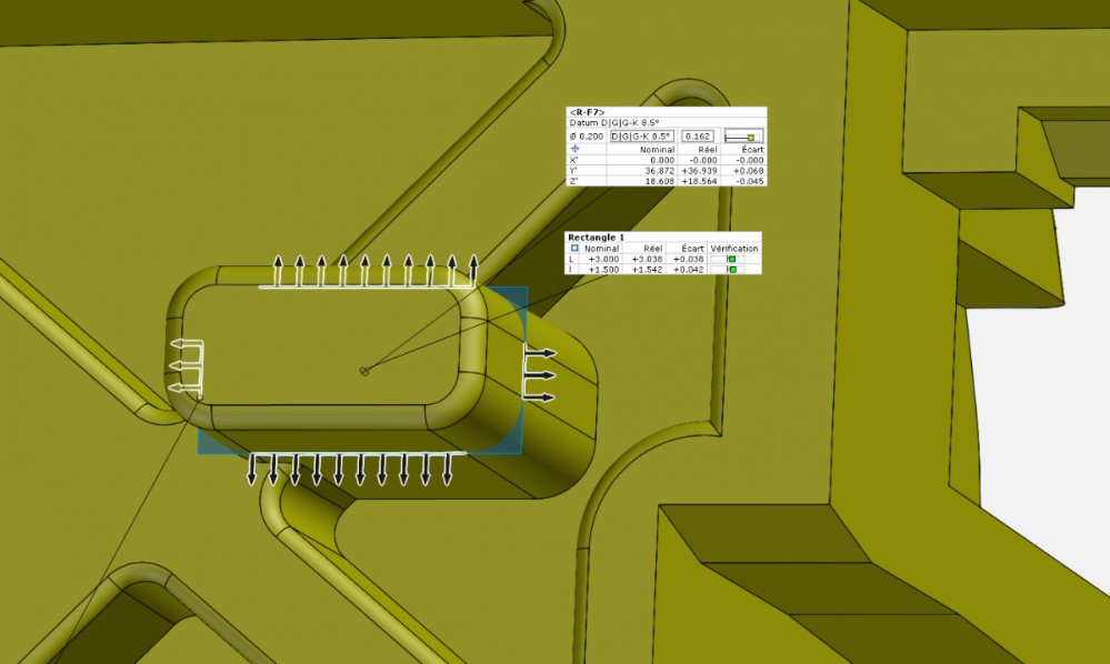

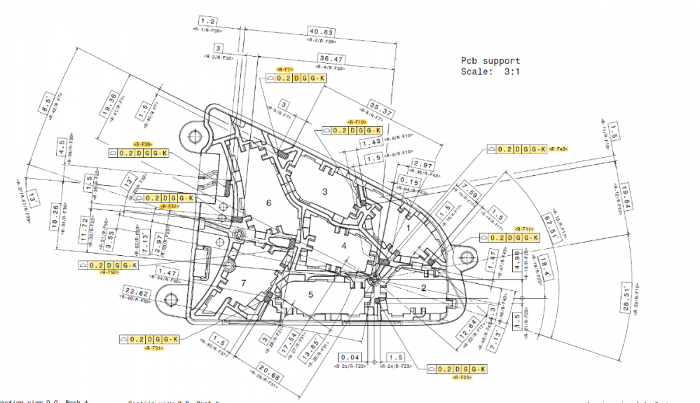

[Ch...] Posted September 9, 2021 Share Posted September 9, 2021 Dear Dridi as you got some questions regarding GD&T evaluation I would recommed to attend the GD&T Trainings we offer at training.gom.com, there is a beginners guide which is free, update trainings and as well we provide courses if you need to be expert on this Level. In general if you need to evaluate a surface profile the patch needs to be taken as surface, otherwise the drawing might not fit. I'd use the surface profile function at I-Inspect and the select the according patches on the CAD to create the profile check quickly. Link to comment https://qualityforum.zeiss.com/topic/412-profil/#findComment-1210 Share on other sites More sharing options...
[Di...] Posted September 9, 2021 Share Posted September 9, 2021 Dear Dridi, Please find attached a small video about surface profile inspection. To get a better understanding on how to use GD&T in our software in general I recommend to visit our training center. GOM Training Center. Just search for GD&T in the upper search field. In the next few weeks you will find an eLearning that is called GD&T Inspection in GOM Software. Especially in this years software version we made the usage of GD&T a whole lot easier. Hope this helps Best regards Dinko 1011876224_SurfaceProfileInspection.mp4 Link to comment https://qualityforum.zeiss.com/topic/412-profil/#findComment-1211 Share on other sites More sharing options...
[DR...] Posted September 9, 2021 Author Share Posted September 9, 2021 Dear Ms Christine and Mr Dinko , Thank you for your answer ! As you did, I selected all the surface to be inspected and I measured the profile of surface <R-F7> .It's OK . And I added the other dimensions related to this profil tolerence juste for information -->will be helpful for the tunning up of the part after . thank you ! Link to comment https://qualityforum.zeiss.com/topic/412-profil/#findComment-1213 Share on other sites More sharing options...
