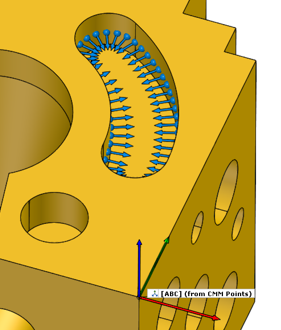

[Mi...] Posted July 22, 2024 Share Posted July 22, 2024 (edited) In my picture below, I have 49 discrete points and I would like to create a best-fit curve through these 49 points. Can anyone help explain how I can best-fit a curve through a series of discrete points? Constructing a Section from Points does not work because it leaves me with an open ended curve, and it also uses straight line segments to connect each of the 49 points. I did find a way to kind of achieve my goal by first constructing a Surface with Patch Compound from CAD, then constructing a Fitting Plane through my 49 points, and lastly constructing a Intersection Curve From Geometrical Elements. Although, this method isn't ideal because I would just like to best-fit a curve through these 49 points all their own (that is to say - best-fit a curve without needing to intersect the other CAD surfaces). Edited July 22, 2024 Clarification Link to comment Share on other sites More sharing options...
[Na...] Posted July 23, 2024 Share Posted July 23, 2024 Hi Mike, you could use the section from points as input for a smoothed spline curve: https://techguide.zeiss.com/en/zeiss-inspect-2023/article/cmd_curve_create_smoothed_spline.html Link to comment Share on other sites More sharing options...
[Mi...] Posted July 26, 2024 Author Share Posted July 26, 2024 Please sign in to view this username. This worked out great. Thanks for pointing me in the right direction! Link to comment Share on other sites More sharing options...
