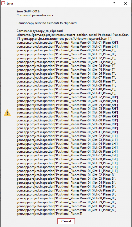

[J...] Posted July 31, 2024 Share Posted July 31, 2024 When I try and copy a cluster within GOM I get the message. "cannot copy selected elements to clipboard" and then the list of elements included in the cluster. What am I doing wrong? Link to comment https://qualityforum.zeiss.com/topic/4158-cannot-copy-clusters-in-gom/ Share on other sites More sharing options...
[J...] Posted July 31, 2024 Author Share Posted July 31, 2024 Please sign in to view this quote. Link to comment https://qualityforum.zeiss.com/topic/4158-cannot-copy-clusters-in-gom/#findComment-12134 Share on other sites More sharing options...
[Na...] Posted August 1, 2024 Share Posted August 1, 2024 Hello, if I remember correct the workaround is to delete the measurement series in the project. An older version of the software was affected by this. Nanno Link to comment https://qualityforum.zeiss.com/topic/4158-cannot-copy-clusters-in-gom/#findComment-12144 Share on other sites More sharing options...
