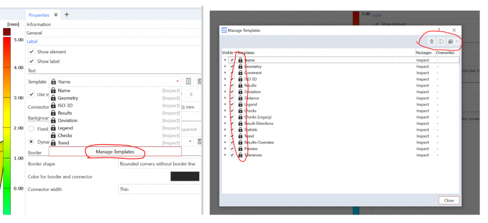

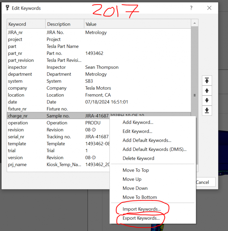

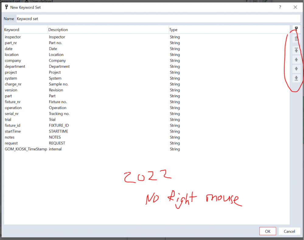

[Fr...] Posted July 31, 2024 Share Posted July 31, 2024 We just switch from 2017 to 2022, there is so many changes between them. I could find import project keyword from right mouse button as 2017. And also, for template for inspection label and legend label, doesn't have right mouse click list. May I get any help? Thanks, Link to comment Share on other sites More sharing options...
[Na...] Posted August 6, 2024 Share Posted August 6, 2024 Hello Frank, in 2022 templates are stored in packages. Are skins available in 2017 already? If you could save the keywords in a skin, export this skin and import into 2022. It should convert to a package. Introduction to packages: https://techguide.zeiss.com/en/gom-software-2022/article/general_package_information.html Nanno Link to comment Share on other sites More sharing options...
