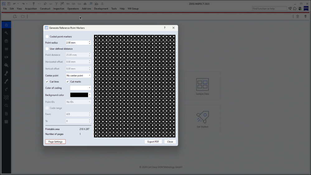

[Ar...] Posted August 4, 2024 Share Posted August 4, 2024 Is it possible to use a marker for gom inspect to identify it as reference points? i.e: to create points that mimic the stickers as actual reference points. Link to comment Share on other sites More sharing options...
[Th...] Posted August 19, 2024 Share Posted August 19, 2024 No Link to comment Share on other sites More sharing options...
[Na...] Posted August 20, 2024 Share Posted August 20, 2024 Hi, you may use the function help -> Generate Reference point markers and print them, but do not expect good accuracy with those. Nanno Link to comment Share on other sites More sharing options...
