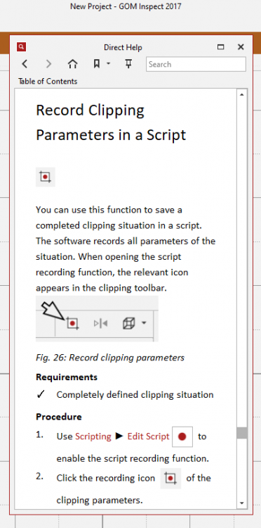

[MI...] Posted August 19, 2024 Share Posted August 19, 2024 Hi, Is it possible to record functions or macros in gom inspect 2023 thank you Here is an example from gom inspect 2017: Link to comment Share on other sites More sharing options...
[Na...] Posted August 19, 2024 Share Posted August 19, 2024 Hi, yes, it is. It's now under Add-ons -> Add-on editor: https://techguide.zeiss.com/en/zeiss-inspect-2023/article/introduction_to_python_scripting.html#mark-0 You can also use Visual Studio Code for scripting now: https://zeissiqs.github.io/gom-software-python-api/2022/howtos/using_vscode_editor/using_vscode_editor.html Link to comment Share on other sites More sharing options...
[MI...] Posted August 27, 2024 Author Share Posted August 27, 2024 thank you, But I don't see a button that records Link to comment Share on other sites More sharing options...
[Na...] Posted August 27, 2024 Share Posted August 27, 2024 Hi, you need to create a script with right click on the "scripts" folder. 1 Link to comment Share on other sites More sharing options...
