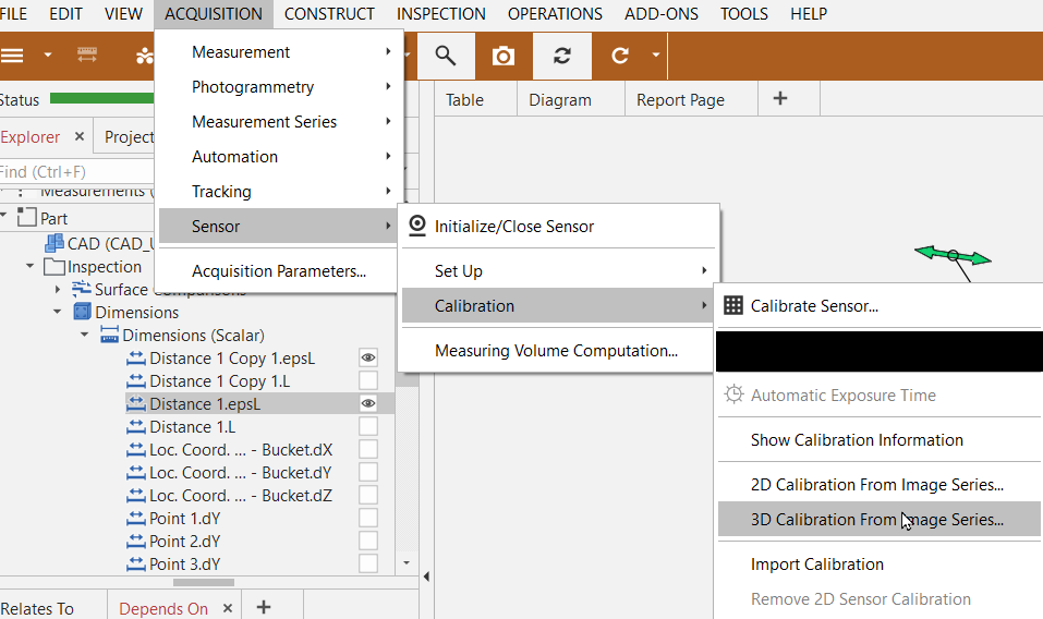

[Ro...] Posted August 22, 2024 Share Posted August 22, 2024 In the Aramis 6.3 software it was possible to create an offline calibration using imported calibration images Is the same thing possible in the new correlate software? Cannot find any info on this topic. Link to comment https://qualityforum.zeiss.com/topic/4211-offline-calibration/ Share on other sites More sharing options...
[Th...] Posted September 10, 2024 Share Posted September 10, 2024 Hi Romke, did you mean this?! Link to comment https://qualityforum.zeiss.com/topic/4211-offline-calibration/#findComment-12464 Share on other sites More sharing options...

[Th...] Posted October 28, 2024 Share Posted October 28, 2024 Don't remember the exact version, but I think at least since 2019... But its a "Pro"-Feature and/or linked to a sensor driver. Link to comment https://qualityforum.zeiss.com/topic/4211-offline-calibration/#findComment-13016 Share on other sites More sharing options...
